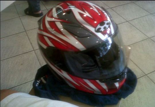

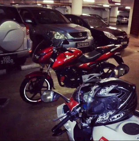

this is how my bike looked after taking the box out.. and i got a new helmet by ogk!!! awesome, light, ventilation is good too!
