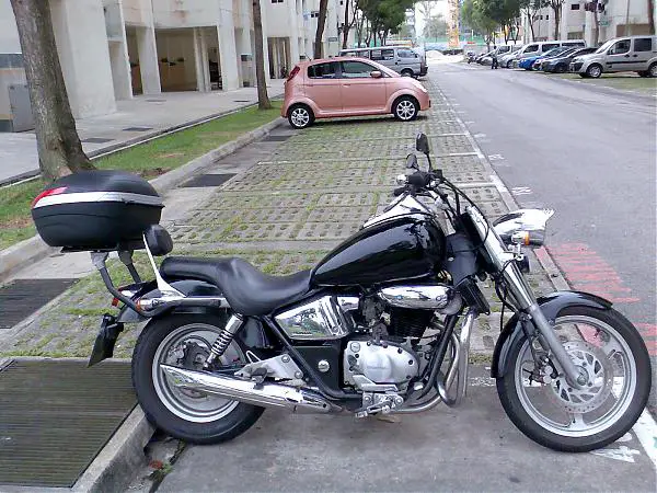

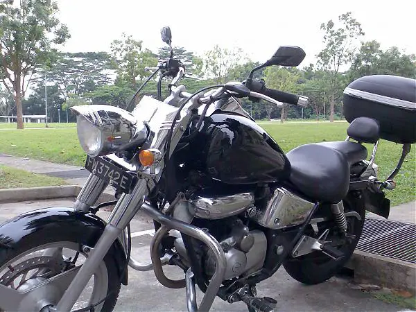

Hi Guys, here are some pictures of My Bikes with the Big Tank.

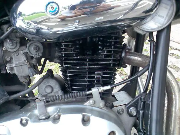

And a close up Pic of the cooling fins sprayed Black.
i remb ah chong telling you the other day not to spray it black cos it will contain the heat more and cause some problems..
but looks ok to me...

wow silent, your bike looks damn nice and clean !
Actually quite dirty, can see grains of brown sand sticking to the cooling fins in the close up shot.
Have to repolish the crash bars too, getting small spots of rust due to rain.
Yes, but the First Law of Thermodynamics says that heat travels from an area of higher temperature to an area of lower temperature.
Next, Black is a better radiator of heat, but also absorb heat faster.
And since heat travels from area of higher temperature to lower temperature, the heat should be more easily absorbed by the Blacken fins and Radiated off to the cooler air around it faster.
Or so that's the theory.
Only problem I foresee is that if the paint is a good insulator like rubber, then I got a problem... :cheeky:

Just came back from JB after pumping full tank.
Qus: How much can the tank hold?
Ans: A disappointing 18 L exactly. :dozed:
Anything above 18 L is spilled.

Silent... abt yr fins sprayed black i dun think its a good idea... esp if yr paint is not conducting the heat at a rate faster then the rate of convection of the moving air around it. Yes the black surface of the paint may radiate heat away quickly but if the heat is trapped between the metal and the paint due to poor conduction, you are screwed. Its like wearing a big black fur coat to keep you cool.
Plus convection itself is more effective than conduction. Info Here. By painting your metal surfaces, you are making the heat jump through a few more hoops to before being gotten rid off. Instead of: Metal Conduct -> Surface Radiation, Convection and Conduction. Become: Metal Conduct -> Paint Conduct -> Surface Radiation, Convection and Conduction. And its that "Paint Conduct" part which is questionable. Convection through the air is also much better at cooling a radiator than light radiation is. Unless you are in space where convection cannot take place. Guess you will only know if yr engine starts overheating on the really hot days we are getting these few weeks...
There was a debate somewhere over this if i can recall.. True blackness and just surface paint colour blackness... to really achieve what you want. You will have to laser pit the surface of the cooling fins on yr engine. Then it will not reflect any light and truely be black; allowing the improved radiation of heat .

Hee Hee Hee!!! Hey Snapel, look on the bright side, at least in the morning no need to warm up so long for the temperature to reach the optimum temperature! :lol:
Anyway I will keep an eye out for abnormal reactions these couple of weeks, just in case. ;)

Huh? You mean the rod sticking out of the chassis with the 2 rubber pieces for supporting the tank or the groove on the bottom of the Big Tank?
Actually I didn't have to modify either of them, since the 2 rubber pieces fit exactly into the groove on the bottom of the Big Tank.
The only thing to take note is that the metal washer under the seat will not fit into the Big Tank, so you will have to screw it without the washer.
