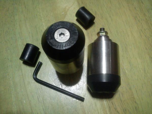

Hi guys,
i got a pair of USED Heavy-balancer with Aprilla engraving on slider (same size & weight as Motovation ones) to let go
Price: S$40
took out from my cb400 :cheeky:
text/watsapp me at 9two3five400one (calls wont be entertained) for any enquiries...
viewing and deal at hougang...cheeeeeers!!!

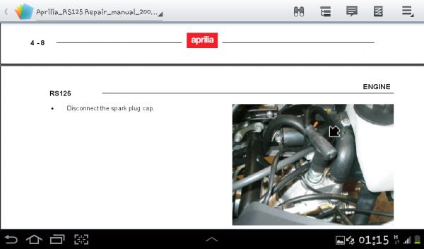

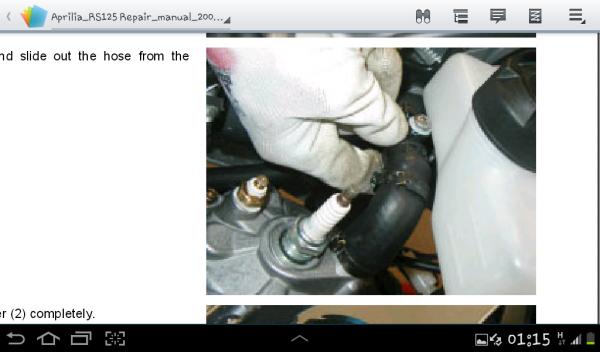

Sorry I'm very new to the bike and I doesn't know how to check the plug. Could you actually guide me ^^ thank you.
the white object in the centre of cylinder is your plug. i hope u know how to open it.
