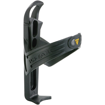

thks Your bottle cage got adjustable base???
Nope... Mine is the Topeak Mono Cage.
