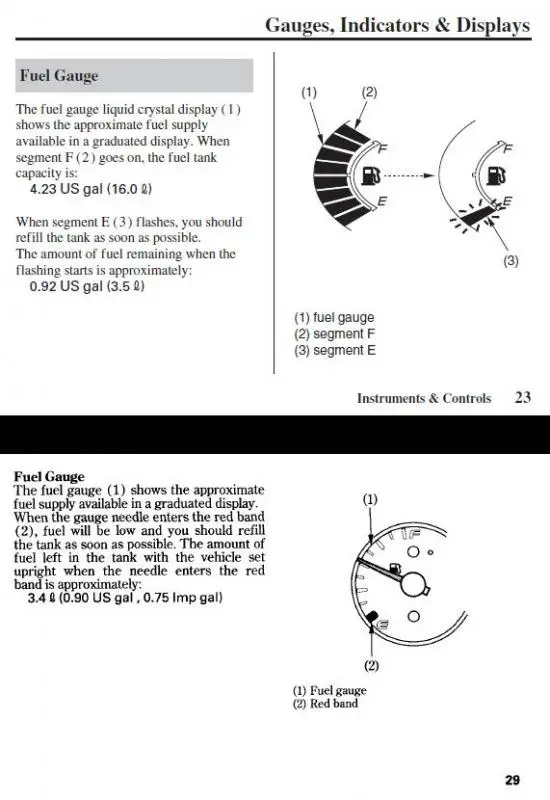

SW full tank is 16 litres inclusive 2.5 litres reserve.
Once pass the red bar and barely touching E is around 12 litres +/-
So once touch E is warning already eventhought should have around 4 litres spare

The JDM suppose is 4L or 4.5?? i guess only
Cos once it flashes, I can get 70km or so everytime
tested few times ride until bike cannot move :)
Wah garang.....imagine empty tank in middle of nowhere or expressway. Worse....push bike, if just 500m away from petrol station:eek:

from the manuals ...
Thanks for correcting, I kept having the impression it is 2.5l reserve.
2.5l reserve is meant for X10 (my previous ride) :D
