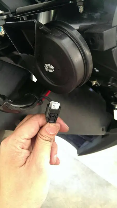

Anyone know where to find the male of this connector? uploadfromtaptalk1391516190970.jpg

Anyone know where to find the male of this connector? [ATTACH]298690[/ATTACH]

You will not find this type of connector in other bikes makers except BMW... "Can-bus connector".
many males can be found here ... http://cpc.farnell.com/productimages/farnell/standard/42381599.jpg

Since you very free, go take a walk in Sim Lim Tower.
You might find some useful thingy.
Otherwise, replace the whole connector to non-BMW...
I see.. Managed to find them in ebay.. 10 usd for a used item.
Sim lim tower don't have such connector..
