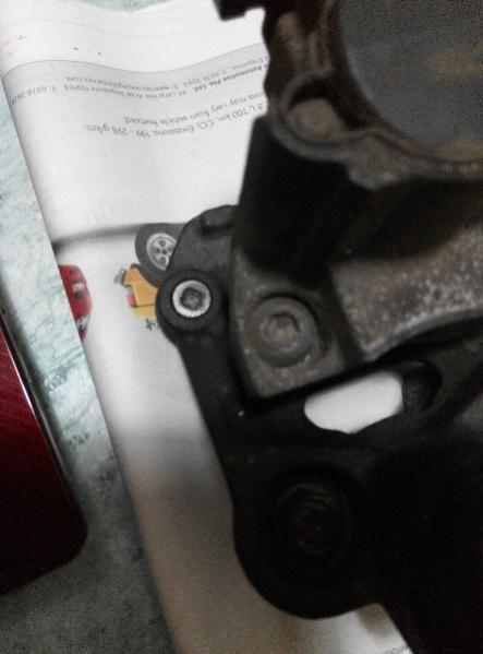

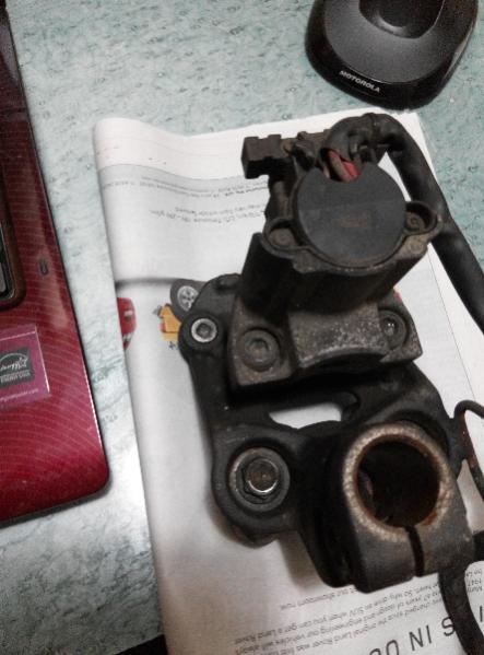

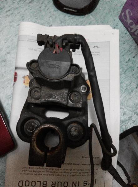

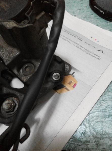

Yo Folks.
Anyone know how to take out the ignition switch from the handlebar clamp?
I duno if that is a square Japanese robertson bolt or hex nut being rounded :lol:
Or there is simply another way to take it out??
P/S: Scooby ...IMG_20140831_230834.jpgIMG_20140831_230849.jpgIMG_20140831_230907.jpgIMG_20140831_230922.jpgthe stuffs you want are ready except for this.
