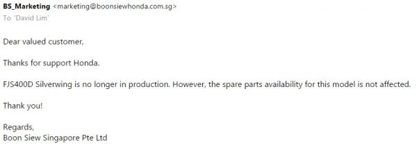

There isn't any more SW-T in production. What we have on the roads that's it.
I think I better service my bike nice nice to keep it road worthy for long long or at least another 5 years till COE ends.
Still got many places of interest in Thailand to cover.
Update:

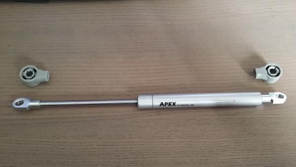

Just replaced the seat gas spring.
1. Bought the Apex gas spring (15kg... should also be ok with 12kg) from a nearby hardware store ($12).
2. Replaced end fitting with metal ones from Nexus Precision ($9 a pair). *Reusable.
3. Add a few washers. No need drills or filing.
Update:
[ATTACH=CONFIG]336445[/ATTACH]
