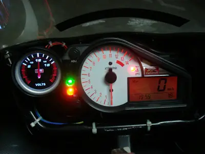

Here's mine. DIYed bracket and installation. :angel:
hey urs is nice .. where tgo get it and how mucH?

Got mine at one of the shops along Alexandra at $39. Think LAB is selling the same one at $30+ too. But saw this exact same volt gauge at one of the 'famous' shop in Alexandra selling at $65. o_O
my voltmeter is the same as urs BUT the voltage reading from the voltmeter itself and a multimeter, it is 1 volt difference. Let's say idling is 11V on the voltmeter, but the multimeter is 12point-something.
Is there such things as voltmeter calibration?
Don't know bout calibration, maybe can be done on those more expensive gauges such as Defi. But for me, plus-minus 1V on the volt gauge is fine with me. As long as it can alert me when the batt is getting low will do. :angel:

i found out that analog voltmeter got 3wires (black, red, orange) and digital voltmeter got 4wires (black, red, orange, green)..
how to diy a digital voltmeter? isit the same as analog ? red and orange together.. black to chassis.. then what abt the green wire?
help... thanks.. =)

hey guys how to install voltmeter huh? Just connect directly to the battery + and - ?? i suckz at electrical stuff...or any bro can help me?? i blanja makan and kopi la. :)

You mean the volt meter comes with no manual??? cannot be rite?
I think Black (-) and Red (+) to battery. And the other one maybe to the headlight(maybe). This is to ensure that once the bike is on, the volt meter will turn on. Makes sense? As for digital got additional, not sure leh. See the manual.

YeA if wanan permenantly on i know how to fix.. jus fix on battery lor. but if bike no den voltmeter on i donno how leh.. of cos all plp wan bike on voltmeter den on if not later low battery lol

from what i know, DIY analog voltmeter..
the red and orange wire connect together, then connect to the point that which is near ur front brakes lever. (the connection point is the brake light)
the black to ur bike chassis... then mount ur voltmeter urself..
understand anot ah?? try ur best to understand.. my english v jialat..

Do not connect the volt gauge directly to your batt. That's what i did the first time i install the gauge. My batt went flat after 1 week never start bike. Connect to your ignition instead, by doing so your gauge will turn on when you on ignition, off when off engine. :p

Ah Boy Selling Comes With Holder Or Not???

It comes with a metal piece but i custom DIY one at my office workshop. :cool:
