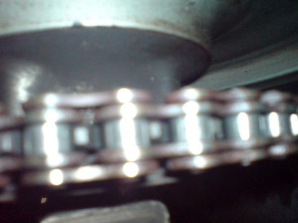

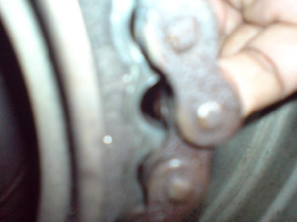

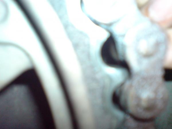

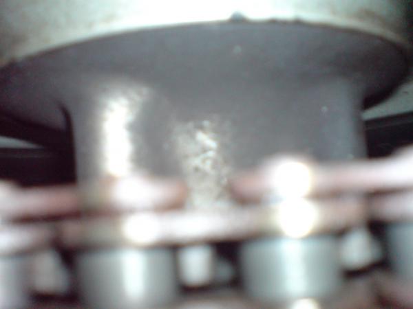

When do you know that it is time to change your chain? My phantom, when I bought, the chain was really dry and some links were really hard and rusty. Then I have oil it and have tightened the chain. Right now the chain seems to be ok but if I hold 2 links and try to move them horizontally then there is some movement. The chain along the rear sprocket doesn't seem to fit tight. I can actually press it and it moves a bit inside-outside so the links seem to have stretched a bit.
I am not sure if I have explained properly. But these are the symptoms. Mainly the links have stretched significantly.I do hear some noise while riding, but its not excessive. So should I change the chain and sprocket or just live with it?
if i were u, i wud jux get a new set of sprockets n chain for peace of mind.. from ur description, it seems pretty worn out.. the chain rollers shud seat in the sprocket teeths nicely, not loose like urs.. looks lyk ur rollers or teeth worn out badly..

Here are pics of how much the chain has elongated :)
Thanks bro. Yeah I will replace the chain and sprocket immediately.
[ATTACH=CONFIG]216890[/ATTACH]
[ATTACH=CONFIG]216891[/ATTACH]
[ATTACH=CONFIG]216892[/ATTACH]
[ATTACH=CONFIG]216893[/ATTACH]
this chain/ sprocket...basket case already
