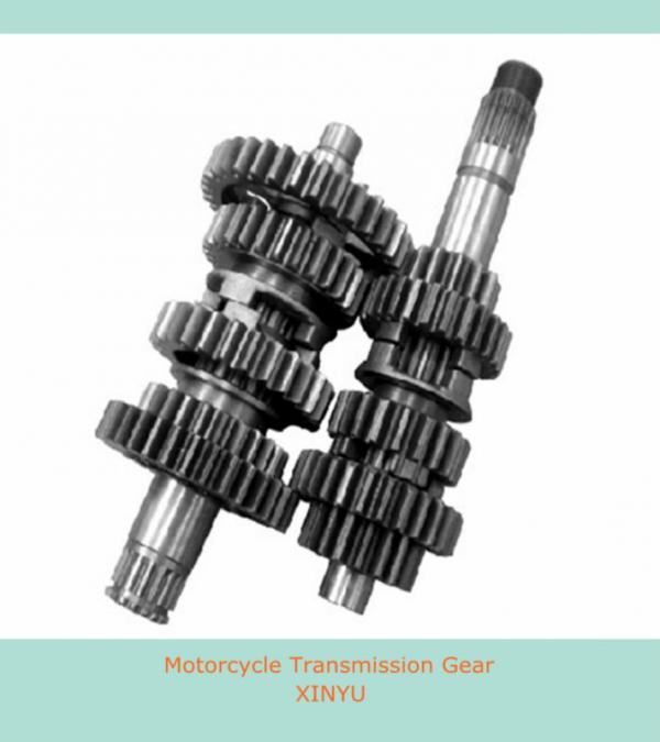

Hi guys,
My Phantom's having some serious problems, can't ride it safely for now. Could you guys please help me out ...?
1. My bike very hard to downshift in lower gears (Gear 1-3), must stomp very hard,
2. Even when I clutch in fully in Gear 1, it moves off by itself. Sometimes even when off killswitch & clutched fully in, bike's still in gear 1, push abit got grinding sound.
3. Very hard to find neutral, must wait for engine to off for a while before it can.
EO was changed 2 months ago. Checked at my usual shop & they said must change gearbox, $800-1000, but found it strange since I can still change gears at higher gears?
Friend helped me adjust my clutch cable, but it was a stopgap measure, problems came back in full force shortly after.
I'll likely need to tow somewhere, any recommendations as to the possible problems & recommendations for bike shop? I live in the west. Tried checking the forums but couldn't find anything that's similar enough ...
Thanks in advance for your help!
1. Describe your throttle position when you attempt to downshift. Is the throttle fully closed?
2. Sounds like your clutch is still engaged.
3. ^
Try adjusting your clutch cable again...pull your biting point further out. When you say 'problems came back', did your biting point 'move' back in? Try to observe whether your biting point is moving 'in', 'in' being closer to your grip (i.e. release a bit of clutch and it engages), and 'out' being further from your grip (need to release more of the clutch handle before it engages).
Hopefully this solves your problems, although your stomping of your first 3 gears has most likely caused some damage. You can upshift without the clutch if you time it right, but downshifts hurt your transmission. If you've been stomping for a long time, the damage will be worse. Try listening to your bike when you're in the 1st 3 gears; any extra sound in that gear, or a loss of power in that gear is a pretty good indication that you have a worn gear.
If it doesn't solve your problem (your problem still comes back but your biting point remains at the same clutch lever position), then...like what your mechanic said...need to change your transmission gears.
As for why you can change gears normally at higher gears, take a look at how a motorcycle gearbox works:
or a simpler one:
You'll notice the sprockets that shift for each gear are different in both videos. But this should at least educate you on how it is possible for just 3 of your 6 gears to develop a problem.
