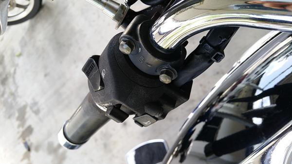

Hi Matthias...besides the bar clamp, can all the other things on the current handle bar fit the 1" bar?
Please see picture for my explanation...Thanks
It won't look nice cos there will be gaps where it's supposed to flush tight. You will run into problems with waterproofing especially for the electrical switches.
Sent from my GT-I9506 using Tapatalk
I would suggest getting a 7/8 bar unless you can't find the exact style you want. Most ape hangers/ straight bars also has 7/8 versions. In the long run, even if you have to change risers which are meant for 1", its easier to use spacers for 1" risers coupled with 7/8 bars then to have all your other fittings presenting a gap which will compromise waterproofing. Unless of course you intended to change the level controls, front brake reservoir, clutch perch, grips all to 1" versions. Gives me a headache just thinking of it.
Hahaha...I got headache too...dat's why decided to get opinion from u..btw i was thinking of changing to a matt black "tracker" bar.
So you're going to lean forward during rides? Cafe style is something doable but you will need to change out quite a fair bit of things.
