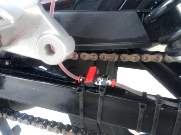

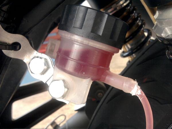

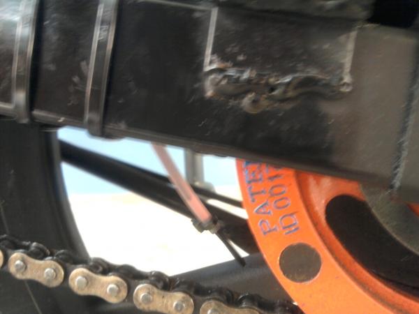

went back to the shop this morning
and decided to get a smaller diameter tubing rather than change the valve to a bigger diameter one
i forgo my regulator and used the valve as an on/off & regulator
cos the tubing is of smaller diameter i pushed it straight into the outlet of the container and use silicon to seal up the outlet part
and the flow rate is slow also cos of the smaller diameter
the valve is good...:thumb::thumb:
tried out riding and no leak at any point of the oiler at all
readjusted my container to make it more straight so that i can fill up more oil and also the oil won't leak out from the top cap
took out the small metal valve from the top of the container and fitted in a plastic plug...when i top up the oil very clean...no dripping outside at all:thumb::thumb:
re-did my set up and here are my pics of my oiler ver 3.0
Ride Safe
Arrive ALIVE
Superb bro! Maybe u wanna clean up the connection betwn the tube and reservoir tip. Make it nicer and super leak proof.
thanks bro
yah will be doing some touching up to make it nicer
when i put the silicon i nv bring along any stick to smooth out the surface
so use cable tie to clean up a bit only
