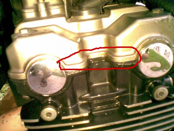

recently just discovered this part of my block is leaking got oil coming out frm the circled area. the mechanic said need to change the o-ring which would cost around 100 plus.. any one encountered similar problem b4?block head.jpg

recently just discovered this part of my block is leaking got oil coming out frm the circled area. the mechanic said need to change the o-ring which would cost around 100 plus.. any one encountered similar problem b4?[ATTACH]174911[/ATTACH]
anyone hav?

anyone hav?
Yes...nothing that uncommon. Since you know the problem...why not go around a few more shop and see if u can get a cheaper deal.
yeah pek but b4 this its not leaking but eversince that time i had a top overhaul at this particular shop then my block starts leaking... guess they didn do a proper job....
If this overhaul job was done not too long ago..try going back to them to have it rectified at no charge of course. U right that its a 'bad' job and likely the rubber seal ring is not sitting properly at certain juncture when the top cover is seated back. $100 is a lot of Hor_Funn and Char_Kway_Teow mannn..and many cups of Ko_pee_Orh!
