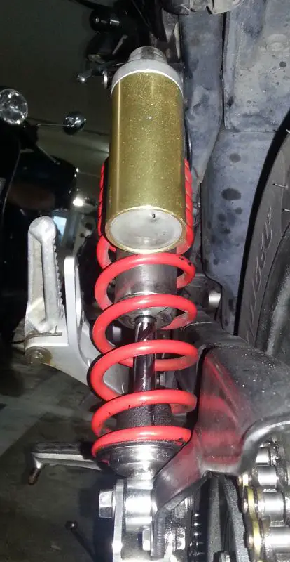

Ah pek,
The gas canister on one of my rear shock got small lobang.. oil is leaking too . any idea if this can be serviced by teck thye or must replace due to the puncture??

Ah pek,
[ATTACH=CONFIG]254722[/ATTACH]
Looks more to me its just the canister undercover cap and the hole was created to did out the cap..no harm. There is no oil in the canister but gas. Anway..u need to service it as the oil is from the oil seal. Mention my name otherwise he may charge more.
