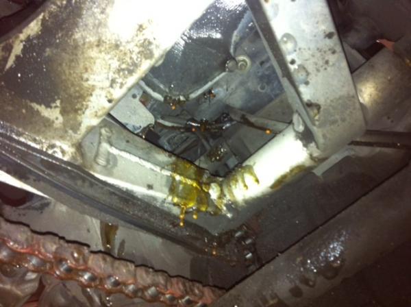

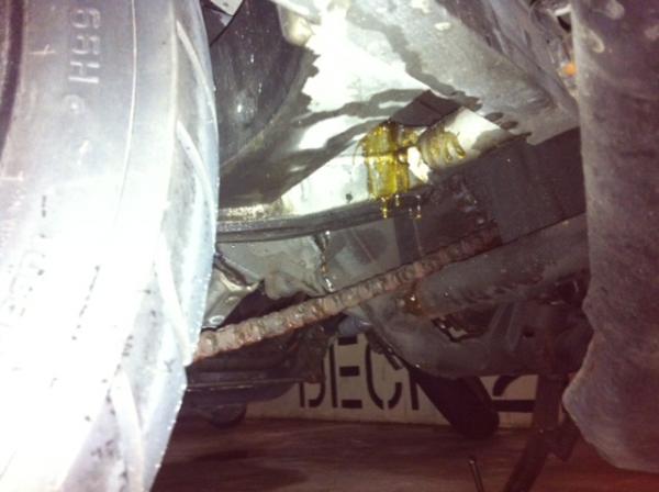

Hi guys, i just encountered this thing under my bike... i was lowering the side stand when i saw some thing sticky glue like substance which upon further inspection appears to have harden, something like super glue... anyone encountered this before?? :(:(
  • Replies 18.1k
Looks like leak from CDI. Think it's common. I try find the advise from Ah Pek.
This is just the epoxy..use to protect the CDI circuitry design being copied melting. The epoxy has reached its 'life span' of bonding together. THERE IS NO NEED TO REPLACED UR CDI..just keep using it.

Hey bro, thx for the advice... Yeap saw that post but couldnt relate it to this current situation... I guess theres no replacing of the Epoxy to protect the cdi... Or there isnt a need to as it is sheltered underseat... Was worried that it could originate from one of the tubings as shown...

There's no cable for de RPM meter. There is a small circuit board inside and probably damage. I doubt they sell just that unit along unless u can savage from a damage rpm meter.
Yah...don't bother about it unless you can buy Evostik glue and squeeze it all in. It was initially don't by manufacturer to protect copying the circuitory. Go bike shop they tell u need replacement bekuz going to spoiled liao.
