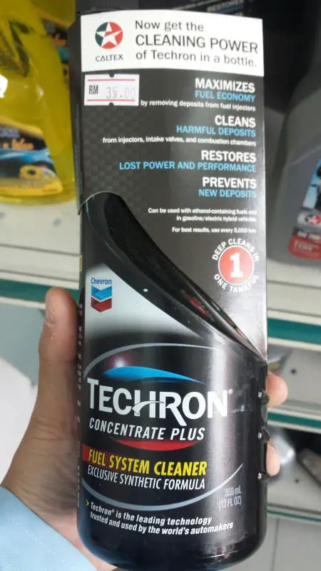

thanks for sharing.The techron fuel system cleaner looks tempting.Have you tried?
http://i249.photobucket.com/albums/gg228/mercenary_017/BusaKenji.jpg
Not yet. but seriously considering it.
it cost about SGD 14 after converting and can treat up to 45 litres. my bike hold 13 litres so it good for 3 treatment.
for $16, you can get Redline SI-1 with about 90 ml more. still, if you are interested in the Chevron stuff, it cheaper then buying in Singapore.
Redline SI-1 and Techron concentrated plus is using the same group of detergent polyether amine(PEA). words through the grapevine is Redline SI-1 contain a higher percentage of PEA although no way to tell are they from the same group.

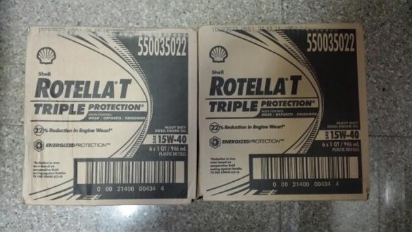

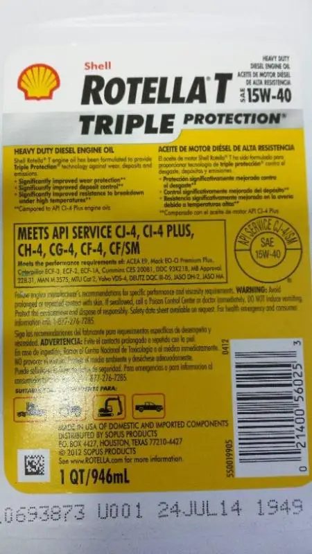

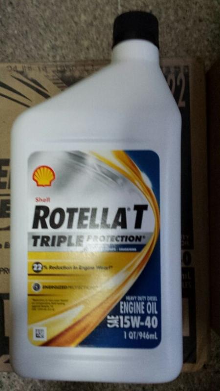

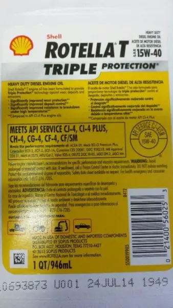

Check up Rotella T product data sheet. JASO MA2 rating and under application guideline stated suitable for motorcycle.

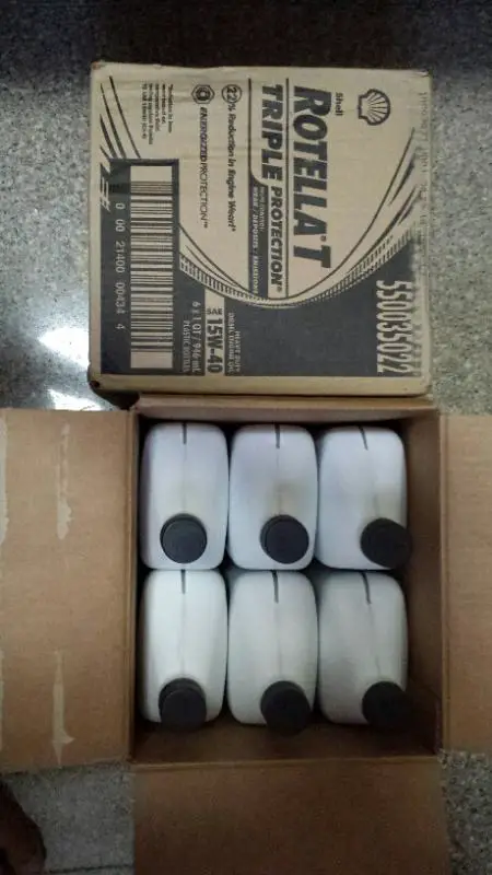

i got it off amazon. about $29 USD so it work up to about slightly below $6.50 SGD per bottle after conversion.
perhps if u get 2 bottles of 1gallon(3.785 litres) around 7.57litres for $30usd would be more bang for ur buck?
I'm personally using rotella t6 @21.74usd a gallon and either of these are recommended to use in a motorcycle engines coz of the jaso ma2 rating.
