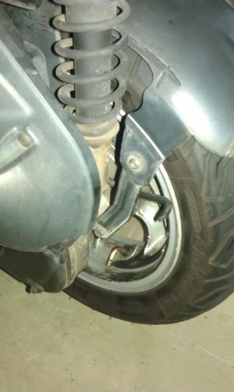

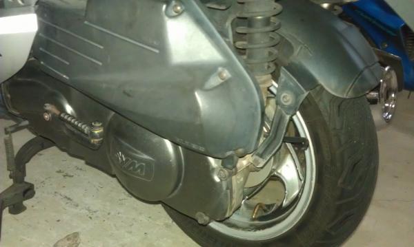

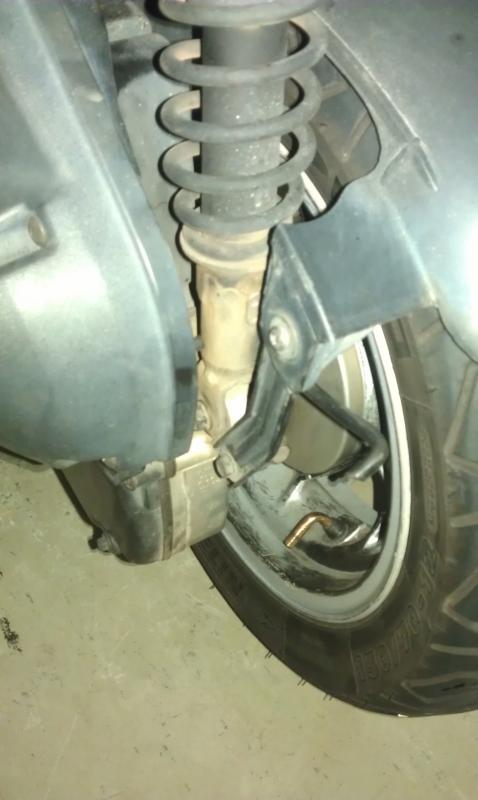

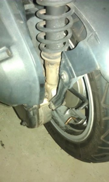

Hello.
I found what appears to be a broken tube (in black, sticking out near the rim) while cleaning the bike. I tried finding the source of the tube from the other side of the wheel, and it seems to be coming from either the airbox or the belting box.
I am afraid that it carries the transmission oil or EO. However, nothing seems to be leaking.. Is there even such a tube that carries either? Please pardon my misknowledge.. Would any experienced eyes please advise me. Thank you!
P.S. Please pardon the lack of info from the pic. I can try to take one from the other side of the wheel (to see where it leads from). Meanwhile, i would truly appreciate if anyone could help!
[ATTACH=CONFIG]318602[/ATTACH][ATTACH=CONFIG]318603[/ATTACH][ATTACH=CONFIG]318604[/ATTACH]
Hello.
This tube is suppose to be connected to the back of the air filter box... i guess its a drain pipe if there is water sipping into the air filter box.

Those black tubes (supposed to be 2 ) are overflow tubes. I had the same concern last time and went down to check.
Overflow for what purpose? I have forgotten.
Anyway no worries ya ^^
