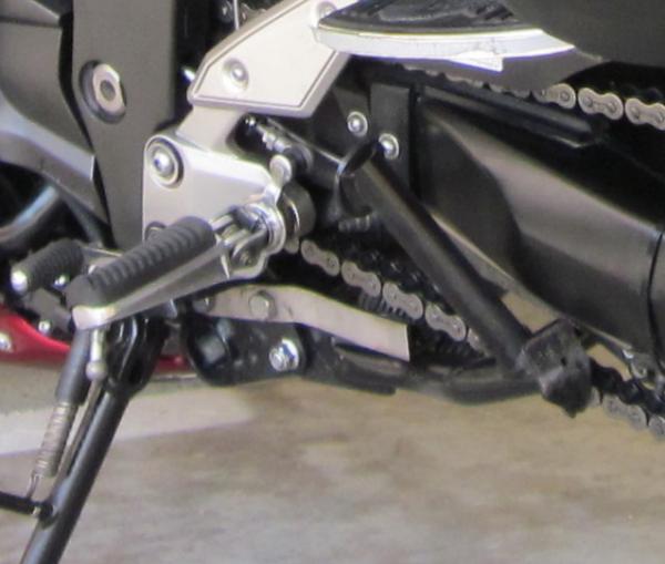

can i also ask, do anybody have this issue on their fz1s? where the mainstand touches the rear shock linkage? esp so with aftermarket pipe cos stock pipe, the rubber on the main stand will come in contact with the stock pipe hence leaving ample clearance for the chain n main stand.

You may ask Seng Kwang to do this for you to support the main stand, underneth this latch there is an extended metal where the main stand touch.
[ATTACH=CONFIG]239613[/ATTACH]
urs is done at seng kwang? Not sure how much will they charge for this.
Yes i believe that will do the trick. The previous owner had done that and even the rubbers like what u did sk8boy on my current bike..

those rubber sheets should be able to last you for long.. a cheaper alternatives to fabricating brackets..
like what sICkbOi-dOt-cOm mentioned, yes his previous owner did that too.. that it last him for very long till he sell his bike.. lol.. no problems with riding be it in SG or MY or even further..
actually, you don't need to worry much.. :)
