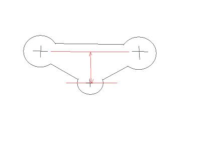

Ok first point to clear is "offset is the distance from the steering axle to the fork" is wrong.. Take a Honda wave, if u were to measure the offset from the center of the frame head tube and center of the fork den the measurement will be wrong. Cos The axle doesn't sits in the middle of the fork. In the case of raked trees, the fork is slanted, which part of the for to measure? So it the center of the head tube to the front wheel axle.

As above, the offset is measured from the center of the steering stem to front axle. So if u wan "X" offset, u gotta take the fork you are using into consideration. For this case alteration of fork lenght will only change the trail,not offset.
