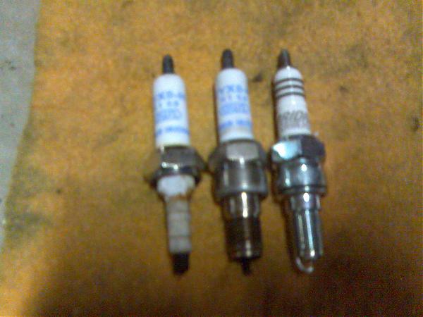

Wonder if any of u guys experienced this problem with OWS Iridium. I fixed the plug 2-3 months ago and more than 2 weeks ago I experienced strange sound. Check with mechanics cant find the problem. Until I DIY my Iridium plugs and found one of the plug Iridium tip is missing.. The sharp needle like tip which supposed to be the hardest element in the Iridium plus is not there. I hope the iridium tip ends up out through the exhaust. After changing to NGK Iridium, the strange sound from my engine was gone. I've wrote twice to UM to verify this problem but till now no reply yet..
Here are some pic,
http://i268.photobucket.com/albums/jj37/bennylim65/th_OWSIRIDIUMPic3.jpg
http://i268.photobucket.com/albums/jj37/bennylim65/th_OWSIRIDIUMPic2.jpg
http://i268.photobucket.com/albums/jj37/bennylim65/th_OWSIRIDIUMPic1.jpg

From left to right:-
Broken OWS Iridium spark plug, normal used OWS Iridium spark plug, New NGK Iridium spark plug.
This picture shows what happened to my OWS Iridium spark plug after 12,000km of usage.
Disclaimer: I'm just sharing my experience with OWS spark plugs and nothing against any parties.

:giddy: ...... :pity: ...... :eek: ..... :faint:

about the OWS iridium spark plug, i heard from my mech dat he had some S4s which had to overhaul cos the tip fell into the combustion chamber and melted there.
and got once he show me a freshly taken out OWS spark plug from a S4 which the metal before the tip had became loose. any more stress to it would cause it to come loose. heng the fella took his ride to the mech for a complete servicing before going on his touring trip
