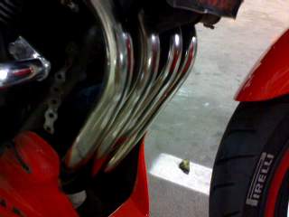

if you want it to shine like dragonforce den go for it!
mine i simply using other meguiar products to clean and coat it.
wah nice nice!
i like the part near the crash bar! sweet man!:thumb:
so shinny. hmmmm gonna make mine shine too!! =D
thanks.. i like your shiny headers man! :thumb: too bad my headers are stock.. haha.. if not i will polish also..

any polish tips ?? my header i keep polish but the stain very hard to go off..

u can try searching for sponges with a rough surface on the other side + some soap water. (as learnt from Kioz and co.) :lol:
Wash, then polish.
the sponge i tried was those used for washing dishes. it's quite effective "scrubbing" off those "die hard" dirts...
sorry just got my s4, but stock header can polish until shiny or only full system do-able?
stock super 4 header can be polish till shine but will be quite troublesome. (i.e. must use sandpaper to sand off the rusts... etc...)
full system header will be able to polish till shine as most of it is made of stainless steel. same goes for Revo headers too, it's made of stainless steel.

stock headers cannot achieve the effect like how like those who have used aftermarket headers or pb1 headers..

i use water and cloth get rid of the dirt at the header first
than use the polish and the rough side of sponge
than the smooth side
than use a clean cloth get rid the black layer :angel:
