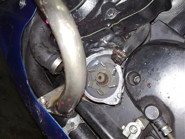

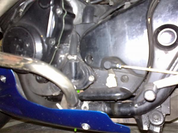

ahpek, just now my mech at jb try to change the seal of the waterpump cover yet my bike still leaking. the mech says to get the water pump cover new one but im thinking what if its not the cover that is defect but the other side which is the problem? wouldnt it be better if get the whole water pump assembly like that?
also do u know if FJT sells the cover only and how much? also if buy with the water pump how much isit? The cover is the "Y" where 2 coolant hoses come into it one. am i right?
just now i otw back from jb my fan constantly turns on so manytimes cos coolant leaks out from the "Y" cover the below part. i think theres little or no more coolant in the hoses already.
what do u think? anw does FJT open tmw morning? (SAt?) cos i wanna get the part asap.
  Quote
Sound more like a bad job than put the blame on the cover housing. There is no way this thing can be damaged. I believe he had it damage while changing the seal. Are you sure he uses the right seal for replacement? Anything JB..I really can't help. It could be a chance he was taking...and in the end, he may have damaged the cover while at it.

hmm.... maybe but the only way i can think of is that he accidentally overtighten it in the first place. however can overtightening damage the cover? also since it was already leaking in the first place could it be happen just like that due to wear and tear?
so what do u think? should i try to buy just the cover or the whole pump?
also do u know wheter its advisable to put adhesive like glue or silicone gasket on the cover (cos thats what the mech at jb did) or just leave it clean, put the seal and tighten? what about ur own coolant pump seal? u ever change it or see it taken out?
yah its the right seal also, i bought the seal at FJT a few days back.
so wasted i used up my MAxima coolant and it all leaked out back again.
tmw morning im going back to FJT to ask hw much is the pump, if the cover add some money can get the whole pump will most likely be doing that. what do u think?
  arsonist said:
anyone can help answer my question? im going to FJT soon.
want to help you but very difficult as there's no pics...
better send ur bike to bike shop to rectify...

uneven tightening of the cover and wrong seal size used also can contribute to the leaking leh...
AMKS4 Riders, Gathering S4 Riders of our Tomato Land
- My current ride, Honda CB 400 Super 4 Hyper VTEC. More pictures @ friendster.com/s4vtec -
http://photos-566.friendster.com/e1/photos/66/56/31526566/1_265855588l.jpg
- Feel free to contact Thomas aka s4vtec @ 969-11-787 should you have any questions about your S4. -
is using silicone gasket or glue on the cover recommended? or to leave it clean and just use the seal and tighten. i think the seal is correct cos buy from FJT and even refer to the manual when buying
gimme a min i try to post the pics tt i have
ur pump look ok on the fins(dono izzit like tt spell one)
like time i change mine cos the whole ting turn rusty sia
