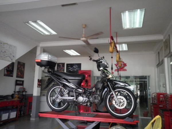

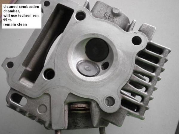

Overhaul Part III
31 March 2011
Meter 32777
132,777km
10:45am till 5pm
Skudai, JB

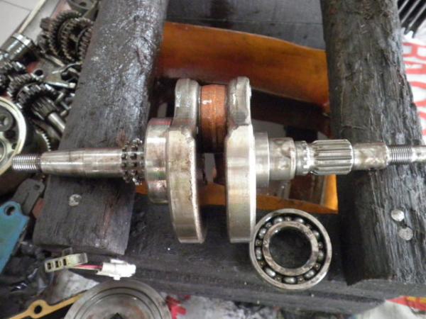

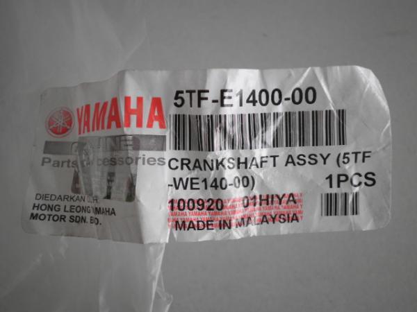

Original Yamaha Lagenda crankshaft one set with connecting rod and single bearing RM342
Did balancing crankshaft in Yamaha HQ SC using gauge
Original Yamaha Lagenda Piston Pin = RM 4.90
Bearing NTN made in Japan 2 pieces. One big for crankshaft and one more small bearing for gearbox body. RM36 Used gauge to compress bearing into and out of crankshaft in Yamaha agent Seng Hoe. NO hammer allowed.

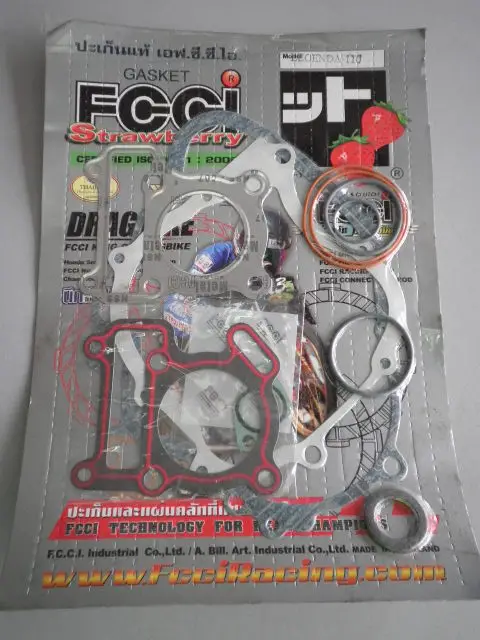

Gasket FCCI set LHS / RHS RM28
Oil seal FCCI set RM18

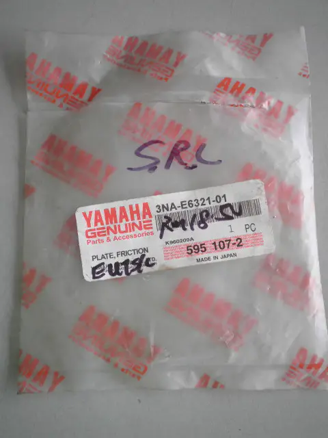

Original Yamaha made in Japan Clutch friction plate. Old 4 pieces very good but one has wear and tear at sides. So better just change now. 5 pieces RM90

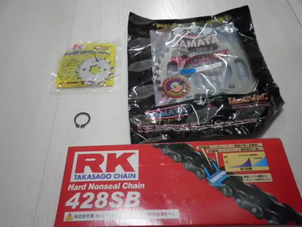

34T Samata steel + SSS 15T steel + RK chain 428 = RM 36
circlip 19 inch front sprocket 60 sen
air filter cleaned only
Carburetor NO need to service. Still very good.
spark plug NGK G-Power RM12

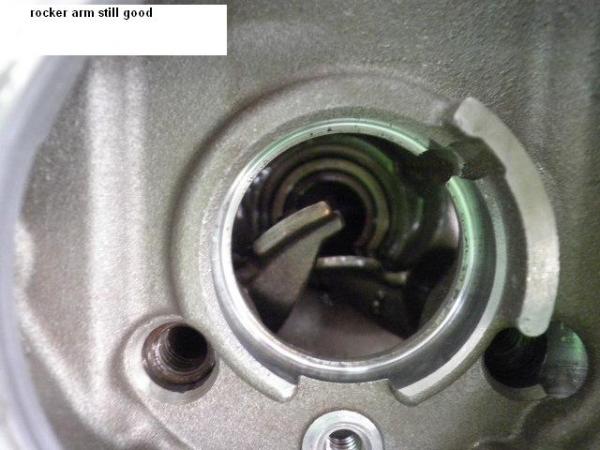

Cleaned piston head and combustion chamber valves and wall

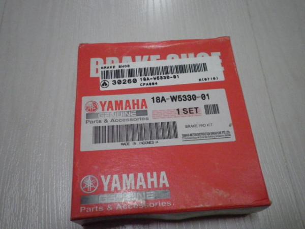

Brake shoe original Yamaha Jupiter made in Indonesia
Engine oil 1000ml
