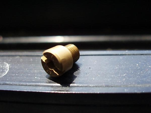

bobktm2,
cannot go above 80km/h
yamaha spark z carburator well known for this problem
mine also hit this problem at 90,000km
just change the main jet number code 105
mine is made in japan directly imported from Kuala Lumpur factory. Took 1 week to arrive to JB and then collected at the yamaha stokis
RM25 per piece in yamaha genuine with holograph packaging.
then after change main jet problem resolved.
bike fuel remains good
at 90km/h to 100km/h constant speed for 4.5 litre tank can get 1 litre 46km.

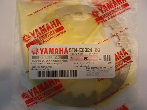

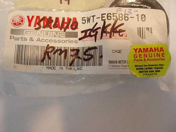

Bought sparepart for clutch set:-
a). 93606-10800 PIN, DOWEL
b). 5WT-56586-00 CAGE
c). 5WT-E56512-00 BOSS, CLUTCH HOUSING
total RM58

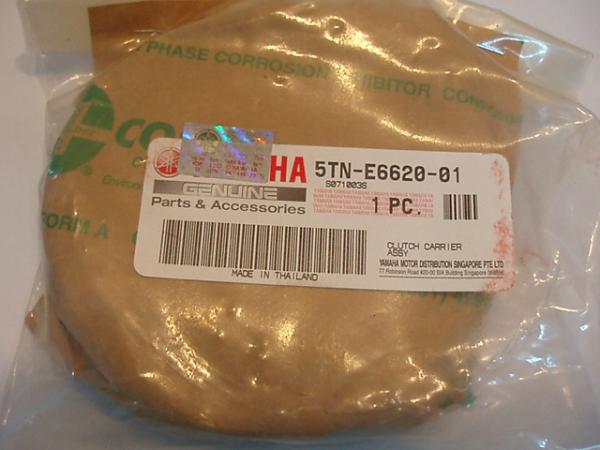

1. genuine Auto Clutch 5TN-E6620-01 = RM130

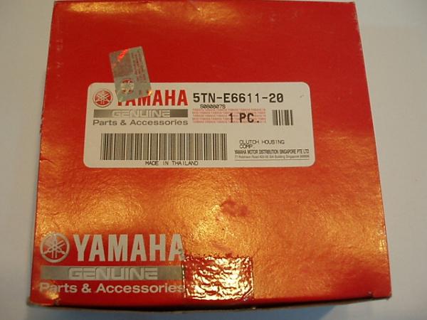

2. genuine Clutch housing 5TN-6611-20 = RM100

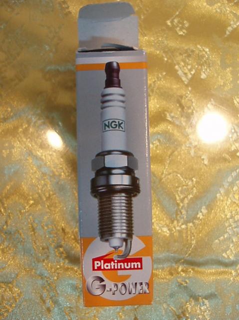

3. G-power NGK RM12.50 *2 = RM25

E6324-5TN-00 plate, clutch steel 3pcs SGD4 each = SGD12

(2x) original Mikuni Carb main jet #105 made in Japan 18A-14143-21 = each RM25

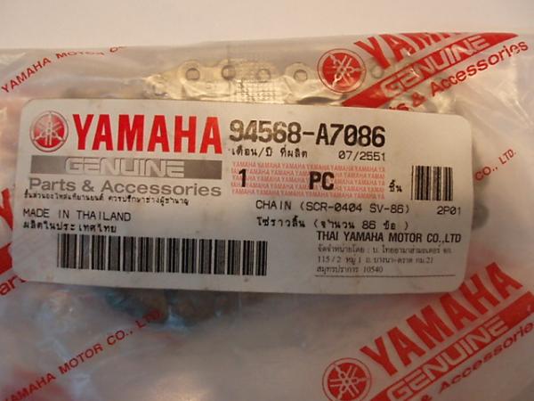

Yamaha made in Thailand Cam timing chain = SGDxx

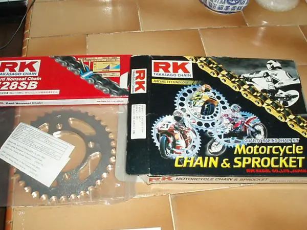

Bought sparepart for chain drive:-
RK set chain + 35T =14T sprockets = RM48
Lube chain = RM8

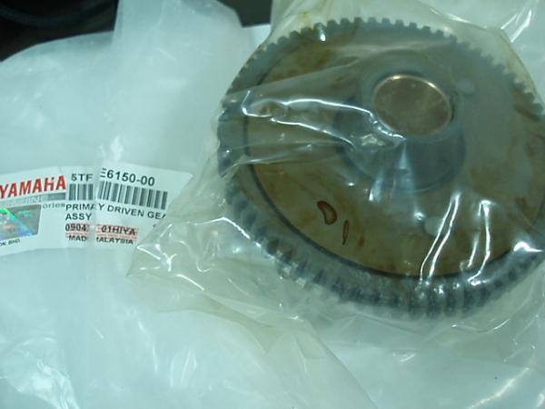

Genuine Yamaha Primary driven Gear = RM130

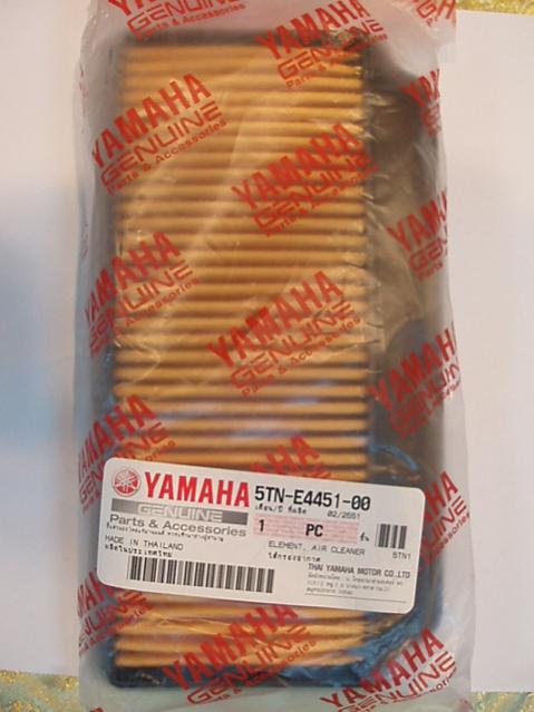

changed air filter original genuine Yamaha 5TN-E4451-00 = RM16
changed spark plug NGK G-Power original = RM12

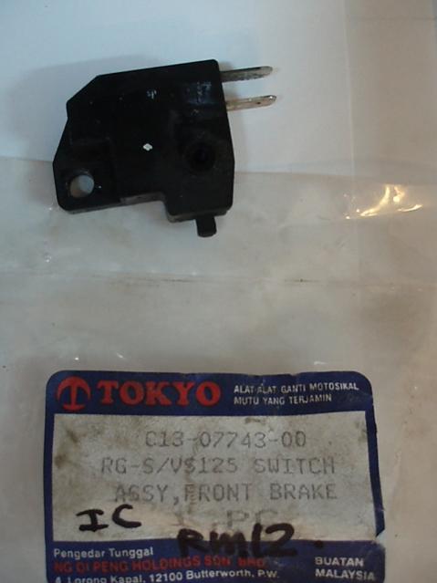

Xe Xing motor
Changed front brake switch cause when press brake lever no rear brake light = RM8
End

After 21.000km usage of RK chain sprocket set, removed the bottom cover cause – chain tension and noisy. Kedak kedak sound.
Then on 15/7/09 rectified the noise root cause. Actually, after Mcpherson changed the Duro tire, foreman did not insert carefully the spring + brake show. The spring dropped and stuck inside brake drum. The spring bent. Brake lining gave loud squeaking and caused chain drive rear noisy. So foreman in Seng Fong, changed the spring and cleaned drum = RM2
No more chain tension. CHAIN DRIVE EXCELLENT.

Changed timing cam chain + sprocket + gasket

see some photos attached

meter 03362
seng hoe
changed RK chain and sproket set
front 14T and rear 35T
clean full chain cover set.
changed air filter
changed NGK G-Power plug
changed dot 4 brake fluid
tighten front fork nut from vibration
increased height of rear twin suspension to harden
then from last week i noticed one new sound coming very loud.
foreman rectified that it is the silencer exhaust pipe has leakage and inner area broke. Cannot do welding and only can change entire exhaust pipe.
Now got two noise from bike - piston and exhaust
yamehe really sucks and pain killer to wallet.
total RM20 labour charge
Thank you very much for your kindness consideration. By God's Grace.

13/10/09
meter 039xx
seng hoe, JB
1. tighten allen screw of givi box which loosen. But this time put glue into hole to make sure it's more tight.
2. took out "main air jet" and cleaned with air and sprayed wd-40. then put into carburator. Now performance of bike is good. The air was insufficient which caused bike lags pickup.
3. put oil into throttle cable to smoothen.
yamehe really sucks and unstable ....maybe to me only
total RM3 labour charge
Please consider the environment before printing this e-mail; Save trees

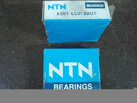

29/10/09
meter:04974
seng hoe, JB
rear wheel bearing NTN made in Japan RM12 - 2 pieces = RM24
reoil into throttle cable
recheck valve tappet using gauge for 2 valves
wash rear light cover
tighten all nuts
changed engine oil shell 4T RM15
service charge RM5

i use NTN brand
made in japan
for bearings in rear and front wheel
see photo
