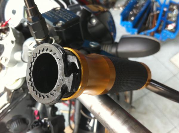

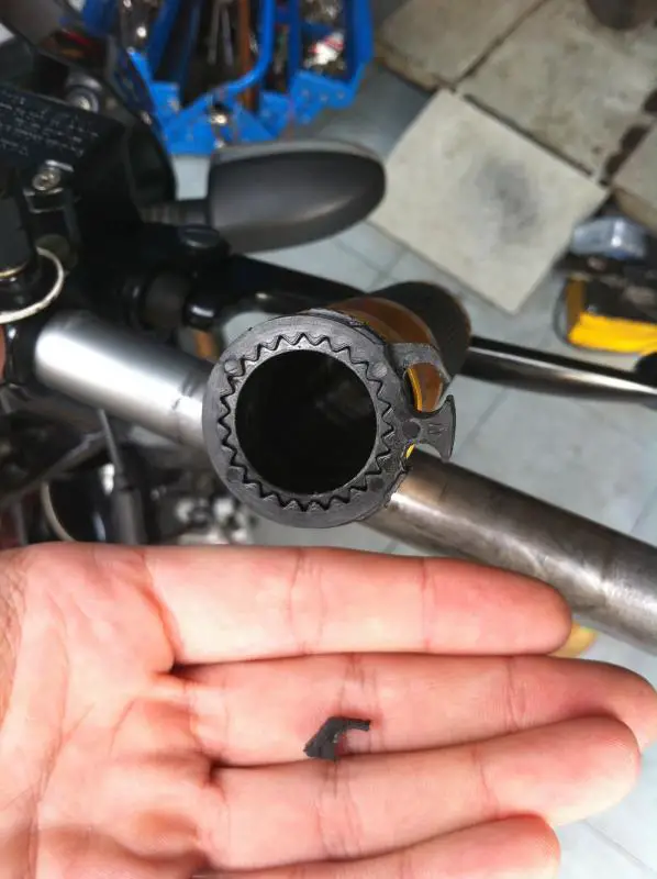

A small plastic part of my Rizoma grip on the side that goes into the throttle box on the handle bar, broke.
It's a small "tooth" that grabs the throttle "pin" inside the throttle box. There are two of these plastic tooth that form a half disk that collars the throttle pin in the throttle box.
I was told it was probably due to the throttle being turned against its normal rotation , meaning like when you close your throttle, but above the closing point.
It might be someone who played with it in the carpark, or it might be me. Maybe when I close my throttle to slow down, I put too much weight on my hands and arms, since I usually tend to tighten my grip when I slow down, especially when I ride with a pillion. Or maybe when I was parking i didn't realize I was pushing the throttle backwards ? The mech suggested it could be that. After repeated behaviors like this, the plastic cracked. it really doesn't look solid at all and I'm very disappointed with the quality - You'd think such an important of the grip would have a better resistance. Especially at the price these grips cost.. !
Anyway, here's some pics to show you what I'm talking about : (you can see in the second picture where the tooth was broken off and the one still there)
I'll go back to unique Motors to see if they have the spare part, but I'm not very hopeful :dozed: . I'll look it up online too.
Any other idea where I could find a new plastic collar, the black one ? Maybe a bike shop changed damaged Rizoma grips and they have the part they can't use ?
I can still ride with only one "tooth" holding the throttle "pin", but I don't think it's very safe..

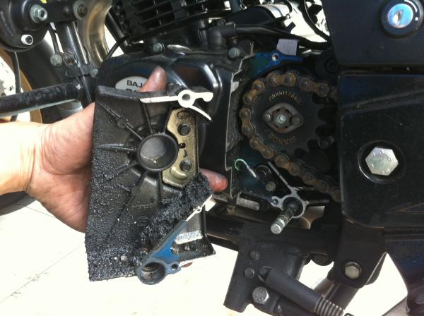

I took the opportunity of my servicing to ask UM to open the small sprocket case and check if it needed cleaning.
You can see in the picture below the findings... Look at the black thick "paste" residue.. I realized that maybe I use too much oil (I use gel oil) and that this type of oil makes it easier for dirt to be stuck and aggregate there. What do you guys think ?
This is the dirt accumulated over 7.5k km. I've never cleaned it before. I'll bring the bike back next week to have my chain removed and cleaned :thumb:
(I also learned how to open the case, and clean the area, and put back the case and how to tighten the gear lever, so if anyone wants more info on that I'll be happy to share the knowledge that was shared with me :) )
[ATTACH=CONFIG]201559[/ATTACH]
Try to get engine degreaser spray (spray and wash) and chain lube oil (oil base)... I doing that every time i degrease my bike... Get pz1 chain lube... Its the best i used so far...
Its looks quite good. Its nicely accumulated at the bottom of the cover in a hard paste form, since you use high quality lube. In my bike's case, it was more gooey and it was all over the place, thats because I used go to bike shops and ask them to lube it using used EO :cheeky:
I would be more concerned about the rust on your chain rather than the dirt inside the sprocket guard.
That said ,its been over a year since i had any reason to open up the sprocket cover. Maybe i should take the opportunity to take apart my bottom chain guards to clean up all that accumulated gunk, and the sprocket cover as well.
