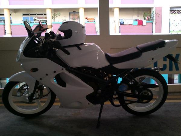

@RainKR Im not going Global Motorsports Ubi anymore. Finished painting but then my ignition key and my Fuel needle spoil. Ive no idea what they did, cant they just take out the body parts and spray as per ordered. haiz. Thx again for the info.
Ok bro, let's just say they did not do anything wrong, just say **** happens.

hw much u done paintwerk
$380 including the rims and body. The paintwork and finishes are quite smooth.
