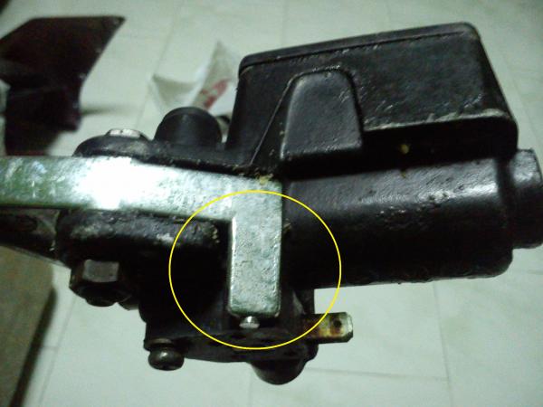

how to fix my break light? if i press my front break there is no break light..
maybe its the bulb ?

wen i press rear break the light have...if i press front break lever t light dun have..
Where do you stay? i can help you if you dont mind provided you stay around jurong area. haaha. have you check the brake lever? there is this small piece attached to the lever which will press down the switch on the masterpump when you press the lever. if that small piece is broken then you wont have any front brake light.
Edited by Sharkboy
the one small round rubber izzit? hahaha i stay chinatown
use cable tie temporary under the lever. i just did mine yest at jb cos my lever is not krr, is actually for 125z.
huh under the lever?? sorry blur abit... mine i use motor gp lever for spark... i only c wen u press e lever, it will press the break pump rubber which is e small round rubber...so where should i put e cable tie??
This was what i referring to about the small piece on the lever. But since you mentioned that you change to those moto gp lever than i am not sure what is real problem here. It either the wire or switch.
