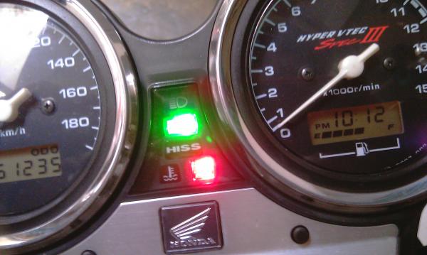

[Q] Hi riders, i am newbie here as just purchase CB400 yesterday.. When i insert the key without starting engine, the indicator on the right below HISS shows RED COLOR.. After i start the engine and on the move, the RED LIGHTZ disappear.. LAstly, when i switch off engine and the RED LIGHT appears again.. Anyone knows what is the problem and what needs to be done? Secondly, pls educate me the what are the two indicators? thanks
[ATTACH=CONFIG]227282[/ATTACH]
1st... welcome my fren..... the indicator shld be low oil pressure... Lights when the engine oil pressure is below normal operating range. Should Light when ignition switch is ON and engine is not running. Should goes out when the engine starts, expect for occasional flickering at or near idling speed when engine is warm.
Hi heskeydal,
What should i do to prevent low oil pressure? Will it affect the performance of the bike or cause the bike/engine to deteriorate?
I am worry for it as I have save so much $$ to buy the bike and dont wish the bike to be in this condition.

If the light still blink or light up AFTER you start your bike, it is adviseable to visit a mechanic the soonest, most likely is Engine Oil (EO) problem.... you can contact @Ah Pek as well for this issue, he is most happy to assist you on this issue....
SideNote, which version you are riding ? if you free.. please look out for S4MG or any gathering by CB400 members please come join us......
its normal.
as long as engine not running, the light is there. when engine running, light will be gone.
