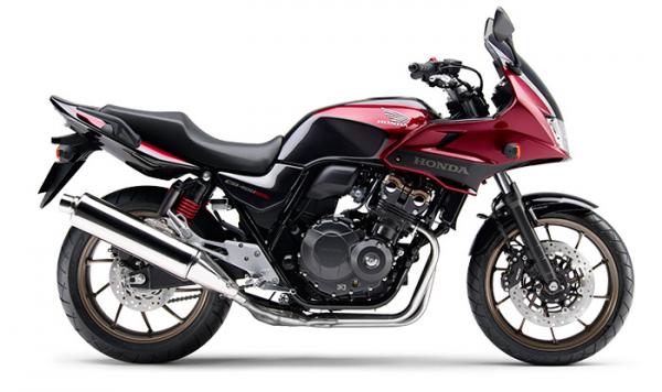

Hi guys, I'm planning to get the 2015 Super 4 bol'dor SE soon, anyone can enlighten me what's the diff between normal Revo and the SE Revo, any diff in pricing? or any advise please?
I Motor quoted Revo bol'dor SE OTR 21800.
You guys can suggest / recommend any shop selling the 2015 Super 4 bol'dor SE.....?
