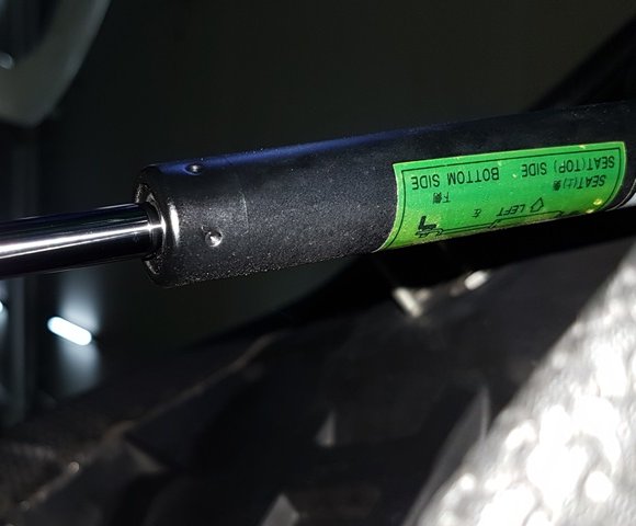

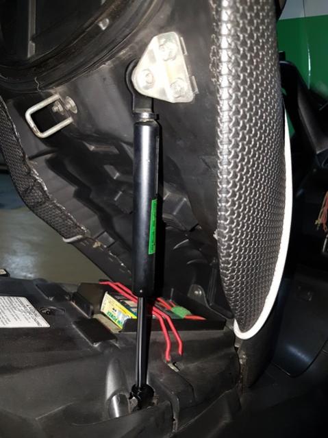

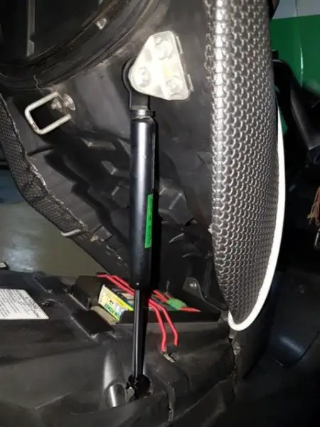

My underseat strut/spring is not holding anymore, where can i buy a replacement and how much? Any bro letting go theirs? Thanks
check this out
* Replacing the Seat Damper-Opener
no need to buy original, can go ACM and let Ah Choong fit one aftermarket/mod unit that's cheaper and stronger, maybe last longer.
i'm now using the aftermarket unit, it is slightly bigger (body circumference) but fits well and seat stays up firmly... strongly recommend that over the stock :thumb:
suggest call Ah Choong to check for availability before going down.

Agent selling $45 but no stock need to wait 1 mth , ACM got stock (aftermarket), was quoted $90. went to neighbourhood hardware store and bought a kitchen cabinet strut, replace faulty strut and all is good now... total cost $9
