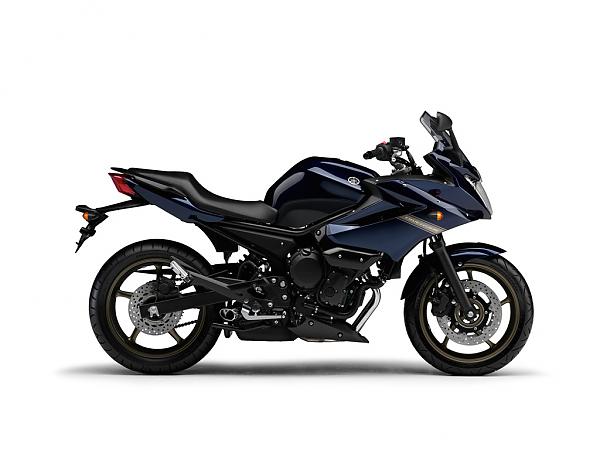

Heard that Diversion XJ6 coming out on yr 2009...
Features -
New 600 cc inline 4-cylinder engine
Easy-to-handle power delivery
New frame for easy handling
Lightweight cast wheels
Available with ABS
Engine -
Engine type Liquid cooled, 4-stroke, forward-inclined parallel 4-cylinder, 4-valves, DOHC
Displacement 600 cc
Bore x stroke 65.5 x 44.5 mm
Compression ratio 12.2 : 1
Maximum power 57.0 kW (78 PS) @ 10,000 rpm
Maximum torque 59.7 Nm (6.1 kg-m) @ 8,500 rpm
Lubrication system Wet sump
Fuel System Fuel injection
Clutch type Wet, multiple-disc
Ignition system TCI
Starter system Electric
Transmission system Constant mesh 6-speed
Final transmission Chain
Fuel tank capacity 17.3 L
Oil tank capacity 3.4 L
Chassis -
Chassis: Aluminium, diamond shaped
Front suspension system Telescopic fork
Front travel 130 mm
Rear suspension system Swingarm (mono cross)
Rear travel 130 mm
Caster angle 26º
Trail 103.5 mm
Front brake Dual discs, Ø 298 mm
Rear brake Single disc, Ø 245 mm
Front tyre 120/70 ZR17M/C (58W) (tube less)
Rear tyre 160/60 ZR17M/C (69W) (tube less)
Dimensions -
Length 2,120 mm
Width 770 mm
Height 1,210 mm
Seat height 785 mm
Wheel base 1,440 mm
Minimum ground clearance 140 mm
Wet weight 211 kg / ABS: 216 kg
Wonder when a shaft driven version coming out :sian:
ç”Ÿå‘½çš„å¯æ‚²åœ¨æ–¼å®ƒä¸èƒ½é‡ä¾†ï¼Œ
å¯å–œçš„æ˜¯å®ƒä¸éœ€è¦é‡ä¾†.
Quite nice aerodynamic looks. Almost like fazer but with different head cowling. Quite surprised that yamaha still had innovative ideas on diversions as I thought that the legendary models are almost obsolete. I think this model is sellable here in Singapore as there are not much 600cc with semi-fairing models around.
