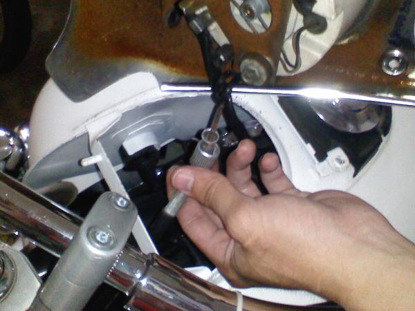

went down to take a look just now.
found the cable on the wheel. then I pull, the other end totally not connected lols..
Anyway, I didnt bring along my bike keys to try out, so not sure if it's still working ,
but I took a picture of it.
is the end of the cable like this? some metal wire with a square shape cross section??
does mine looked normal ? or is this considered snapped?
and sorry for the influx of rust underneath the casing =X
Edited by Shunpo
Adventure.
jus, jus insert it into the hole at the back of ur speedo den tighten the round cap like thingy, pliers wld b recommended than jus finger power... it might jus come off loose agin
hmm, fitted the cable end into the speedo. but still speedo isnt working .
cable doesnt seemed to be broken within either =X
later pull everything out and see again. if really spoilt means tml ah chong visit
Adventure.
What about the other end of the cable, the end connected near the wheel?
Maybe BOTH ends loose?
And if you want to test very easy, hold the wire in your hand like in your pic, then push the bike a few meters, if you can see the wire flat head rotate, that means the cable inside is ok.
If not then either the cable other end is loose as well or the inside snapped, so cannot connect to rotate.

Went to take a look again. I checked the end at the wheel , nothing wrong with it, works fine. I did the test that you suggested, and the wire head does rotate.
Mine wire head is a little rusty, any possibility that it affects the rotating mechanism within the speedo socket?
If not , and if the wire is considered working condition through these tests, what are the other possible problems of the speedo not working?
speedo itself spoilt?
Anyway, slightly at the bottom right hand side of the speedo, there is this L shaped rubber tubing. Is it supposed to be connected to anything?
