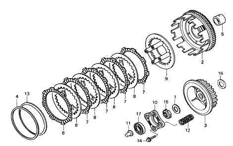

btw kinda curious how does a cluth plate looks like? haha. where does it reside in the engine?
see the attached image.. E06 CLUTCH PACK.jpg they are a series of alternating plates of friction material plates (parts 6 and 7) and metal plates (parts 8)but the ones u will be replacing will be the friction plates that would be worn..

see the attached image.. [ATTACH=CONFIG]268649[/ATTACH] they are a series of alternating plates of friction material plates (parts 6 and 7) and metal plates (parts 8)but the ones u will be replacing will be the friction plates that would be worn..
