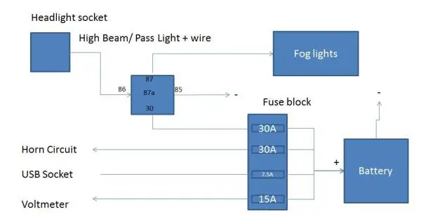

I connected the fog lights to the high beam wire in my headlight switch. Do I need a fuse from this wire?
[ATTACH=CONFIG]315374[/ATTACH]
Indeed. Always an inline fuse whichever line your tapping power from. (is that wire 12v hot? ) anyway why not u correct direct to battery? I'm not too sure its OK to draw so much current via that circuit. Your inline fuse may not fuse first and your main fuse will go first if load is high. (may)

I use the high beam wire so that I don’t need an extra switch to control the fog lights. The power to the fog lights are tapped directly to battery. This way of aligning the circuit means I can use the passing light switch to "flash" the fog lights also.

No wonder u wire that way lah. Too bad old type Phantom don't have the passing switch.. Don't like to use high beam.. You are using both lights together?

I'm putting an interval switch inbetween so that I can choose to use 1 or either both.
