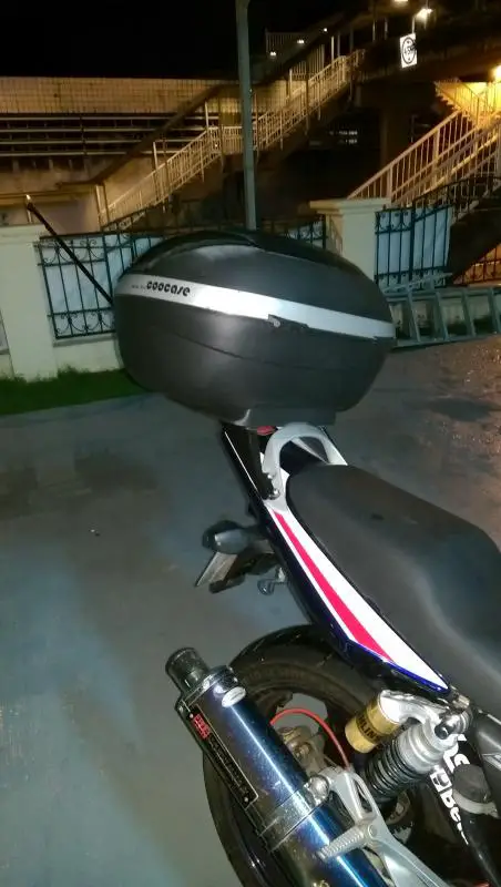

I saw this cb400 spec 3 with the "short rack" for the box.
Basically the rack is attached to the pillion handle screw.
Any idea where to get them in Singapore ?

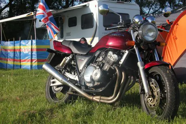

the other day riding arround London city I noticed that the bike after 20-30 minutes working with no issue(my daily commutte to work is 10 minutes ride), starts the problem if I let the iddle down in traffic lights the bike stops. the first thing I thought was missing coolant, after check the coolant level was nice I went yesterday for a ride because was so sunny. after a while in the motorway arround 80mph start to happen the same: start to feel lack of power when twisting the throttle so I pulled over. after a while when the bike cools down start again ,I also got a DRZ400SM wich I blowed the cilinder head gasket because it was leaking coolant. with the Honda cb 400 sf wasnt the case, the whole radiator was hot and the cooling system works fine and the oil still got oil colour, I mean its not mixed with water. The guy of the brakdown recovery says that its something dirty in the carbs because often happens to him doing motocros. but 2 months ago I ultrasonically cleaned the carbs and new gasket set, carbs shouldn´t be the problem.
Ive got laser termometer and reads abrout 59º on the clutch case,95º on the head cilinder and 90º radiator
The sympthoms are like overheating like when you run out of coolant.
This morning it tooks a bit longer than usual to start with the choke on, once started the bike was pulling nice and smooth again.
did this happen to any of you guys. so if you have any clue of whats happening please tell me about.
I left here a picture of my baby last year at Donington Park during the World SBK UK round. I love my 400 and I need it ready for miles because I´m going this june to the Isle of Mann to watch TT races and she needs take me to the island
thanks so much for reading.
I mean the temperature for me its nice, this engine likes to work warm. I don´t wanna give the reason to the recovery guy because i left the carbs like new, I´m thinking on termostat not opening at all or any scale or obstruction in the inner holes of the cilinder. Otherwise I´ve never seen a red light of high temperature either fan working.
