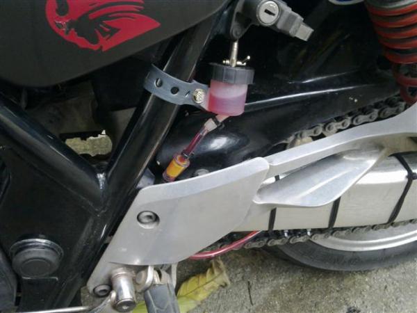

got a question for diy oiler users.. would having more oil in the reservoir result in a significantly higher drip rate? i.e. when just refilled the oil vs when reservoir at halfway mark. would you guys have to keep adjusting flow rate?

[ATTACH=CONFIG]185604[/ATTACH]07102010828 (Small).jpg
Hi bro hope the pic is clear enuf (this is the only pic i hv hehe!) i hv 3 valves in total.
Valve 1 on top of reservoir. (ON/OFF air flow)
Valve 2 under swingarm - MAIN ON/OFF valve (orange valve)
Valve 3 under swingarm - control flow rate. (black valve)
Valve 1/2/3 close - NO airflow, NO lube flow.
Valve 1 OPEN BUT Valve 2 CLOSE - GOT airflow so lube flow to Valve 2 BUT STOP.
Valve 1 OPEN, Valve 2 OPEN BUT Valve 3 close - GOT airflow so lube flow to Valve 3 AND STOP.
Valve 1/2/3 OPEN - Straight flow. Use Valve 3 to control dip flow. IF dripping still too fast use Valve 2 to further fine tune.
U can use 2 Valves but i prefer using 2. I heard u can use pumping method like Ezzyoiler but not sure hw.
There are other styles the bros here did u can ask dem too. Hope the info are sufficient. Gd luck & cheers!

actually if using the gravity feed no need the air flow valve also can
just make sure your oil container is high enough
i using only 1 valve the metal one to control both on/off and flow rate

thought of doin like urs but i kiasu 3 times the safety but also 3 times the headache hehe

i tried making my own version also. but than realized the valve was leaking, so i took the whole thing out for now, until i can find one suitable valve. saw the previous thread. might go have a look.
Anyway, if no airflow valve, assuming the top of the bottle, it wont flow out if the whole system is tightly sealed. There will be a vacuum in the bottle preventing the oil from flowing out(theoretical), which will affect the flow(if there's any at all).
Just my 2 cents.
that im not too sure bro but in theory becoz of a vacuum space there will not be any flow. however u can try...
tried. almost no flow even with both the on/off and control valve open to max. the minimal flow was present because of the leakage of the valve. Note to self, valve is very important, also make sure got airflow valve( actually just a small hole on the bottle will do)
