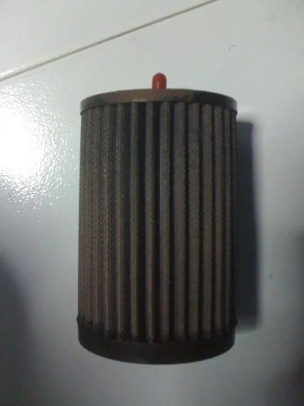

Btw, does anyone know if this K&N airfilter can be used for Ver S?
The mechanic took it off my bike he told me this one cannot use for super 4? o_O
He wanted to keep it, but I took it back.
Part number - A035B6
Wah_Lau!...this type of mechanic also got!!!???:faint: What shop is this man??? You should asked him why cannot? :sian:
Everyone is using this K&N filter for non-Vtech including myself. I wonder how many he collected liao.

I ask him why cannot then he say this airfilter is not for S4, so he fitted a stock airfilter in >_> . Better to change back? Or keep it stock?
I heard if need to fix back need to oil it or what right?
Use what oil ah? Can use your magic oil onot? :angel:
Forget about spending so much on the so call "Recharge Package" for Hi-Flow filter like K&N and others. Go mixed soap water (20% and Kerosene 80%) and take a used tooth brush and just gently scrub (don't use force). Let dry for a day or so or if you have access to a compressor blow gun..that be faster and can put back immediate after oiling it.
For oiling..thinnest oil u can find like 5w-10w. "Singer" oil is good liao! Get a spray and just a light layer ontop. The oil is only to help trap dust better.
Anyway...most of the time Hi-Flow filter need no cleaning and last up to 100 of Kilo km unless your work or travelling environment is freaking dusty liek working near or at constriction site.
Power la Ah pek, later I go try. Swee swee wash, dry and oil then put in.

Eh Ah Pek, quite interested also to put K&N filter on my PB1. What is the part number ah, maybe i could get one. Anyway got any different or not if i use stock and K&N filter? Also do i need to tune my bike if i use one? Thanks in advance and Cheers...:cheeky:
Yes..you can. Basically..they are "Hi-Flow' filter, meaning..more air thru filtering to the inlet carbs intake. As far as effect is concern..don't expect much as the "Air Box" where your filter seats in is a designed calculate volume. Just that this so call sometime "sport filter'" provide air faster to feel the volume in case the standard type is clogged with dust or debris from the environment. If you wanna use K & N or any others, have the air intake rubber hose in the air box cut off a 1/3..NOT HALF! This shorten the distance for the amount of air intake to the airbox..basically faster and uses the hi-flow filter more effective.
No need to tune the carbs..its a load of **** when ppl say you must. By comparison with the stock..the stock is better, just that it's not reuseable and cost $45-$55 and don't cut the rubber air hose intake.
OIC, thanks Ah Pek for the info. Anyway you got the parts number for the K&N filter u are using? There is a CMO on the forum that selling them so maybe i could get it from them. Thanks again....Cheers
The original made in the USA one is about $128. Those selling $70..really, I do not know where they come from though the packaging is printed from States US..but I know its not. Original used to be only $98.
Anyway..can use lah :angel:
