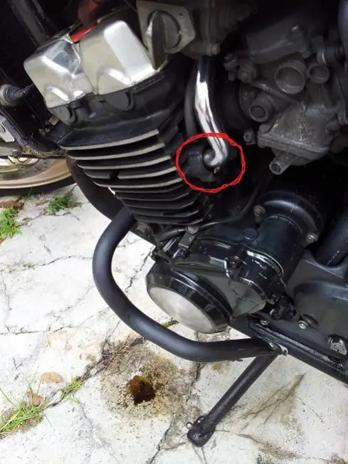

hi peeps,
this morning when i was starting up my ver s, suddenly the joint circled in red starts to ooze out some blackish liquid.. any idea what's happening?
after warming up the leakage stops though..
recently just did coolant flush, changed the 3-point coolant hose connector and the 3 hoses connecting to it cause wanna replace the starter carbon..

hi peeps,
[ATTACH=CONFIG]255514[/ATTACH]
The seal inside the tube has gone back due to wear and tear..or taken out and never changed..get it replace..seal (rubber O ring.very common) is only a few $s ($1-$3). Can DIY by just unbolting the size 10 bolt and pull out..some coolant may come out. If its a bad job from ur previous mech..go back to him.

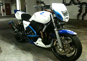

any one know what headlamp is this ?
look awesome sia !!!
this is a sonic headlamp....
Up to individual... i pref the stock look though ...lol
U can get it at LAB, Aunty or gd deal go Msia Ah qua lane...

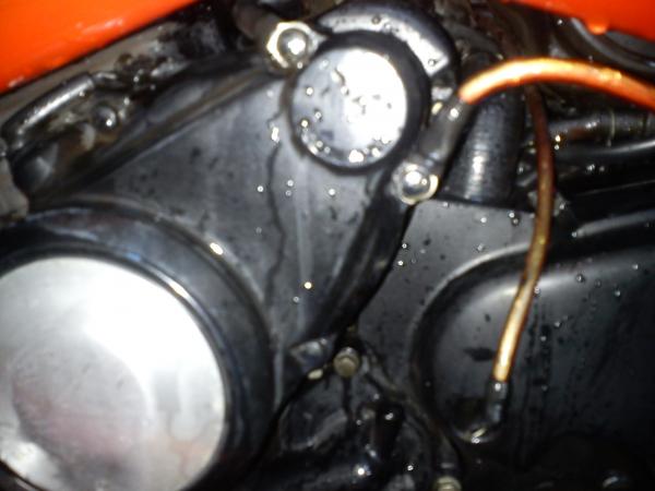

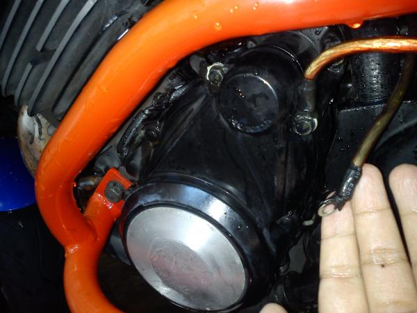

hello Ah Pek, i jz realised one of the grounding wire is dangling, not attached to any bolts...last few mths i went to service my carb n clean air filter at workshop i think they forgot to put back and last week then i jz realised lol :cheeky:
Two other wires are attached to different bolts and 1 is not...where to attached tis one to ah?
Anyway i noticed the color of the wires are kinda fading off liao...any maintenance needed?
previous owner did grounding wit u early last yr...
[ATTACH=CONFIG]255645[/ATTACH] [ATTACH=CONFIG]255646[/ATTACH]
Propably park under open and exposed to sun and heat..but its okay only colour fade. Washing carbs and filter need not to take them off leh?
