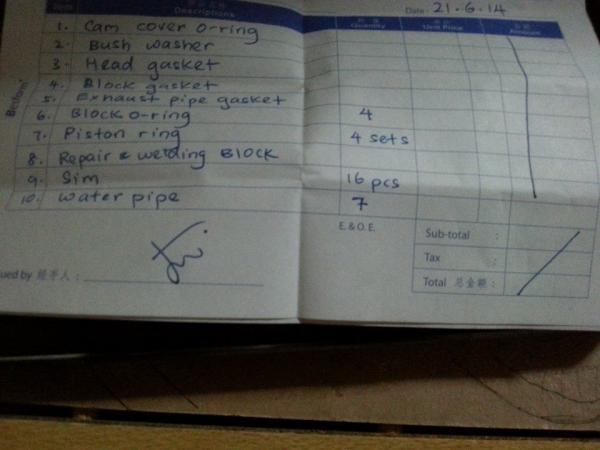

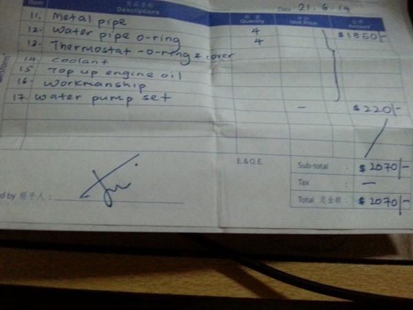

hi Ah Pek. here's the receipts for the work done on my engine and cooling system. turns out didn't cost as much as $2500. but still quite steep. i would appreciate any comment you may have. if not for me, at least can share your critique with everyone here. :)10364128_10152063322101504_5628386587408107672_n.jpg10486205_10152063322036504_359251229930295580_n.jpg
