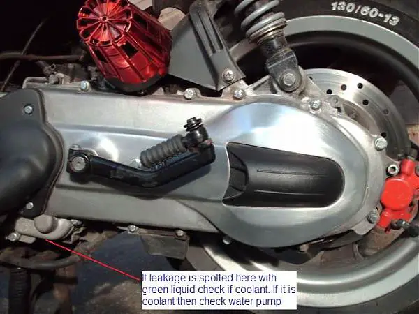

hi, just wanna know, what are the different type of open pods for 2 strokes? onli malossi?
thnx in advance for info..
n my gear box(the part where got the kick starter) got some green colour liquid (prob 2t) leaking from between the gear box and the filter box.. i went taihin mechanic clean for me say if leak come again, duno wats wrong..
i went sunrise one mechanic say duno oso, he first time see, like very blur.. another from sunrise said its normal, just change to open pod n i wont see it.. so basically m i supposed to change to open pod, to just not see the problem or will it help?? problem since july...

Green colour liquid? Could it be coolent? o_O
2 strokers coolant leakage within internal trasmission...ever happen to my fren b4...try send to machspeed...mayb they can ractify for u....

go n feel if the green colour liquid is coolant or 2T...touch it smell it.
If it is leaking from the left hand side of the side stand at the bottom n it is coolant, ur water pump seals r gone..u will need to replace the water pump bearings, shaft n seals.
Please c attachment pic if u r talking about this location where leaking is spotted

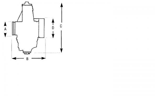

ok riders, for open pod, u can just get a universal clamp on filter from any air filter manufactors to fit on ur carb...juz make sure u have buy the filter with the correct diameter opening according to ur carb n check the overall diamension of the filter n c if u hav enough space to fit on ur bike n have enough clearance.
http://www.ramair-filters.com/motorbike/pics/mr_dia.gif
The neck diameter of the above pic must be slightly bigger than the "D" diameter of the below attached pic of a carb.
Other than that, the overall height and outer diameter of the filter (above) pic must have enough clearence around the area of the bike where the filter will be
