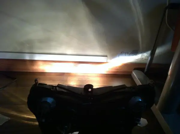

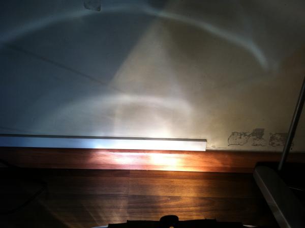

headlight is like money.
it is never enough!
kekeke.
[ATTACH=CONFIG]214794[/ATTACH][ATTACH=CONFIG]214795[/ATTACH]
pic 1 w/ projector lens 55W + one 25W bulb
pic 2 with dual 25W bulbs (one slightly whiter than the other)
learning point: when the wording on the lens indicate "TOP", dont attempt to rotate & mount it slightly off. it will result in a slanted "line" of light being projected out as shown in pic.
:cheeky:
it is never enough!
kekeke.
:cheeky:
it is never enough!
kekeke.
:cheeky:
