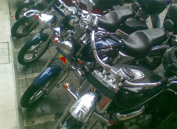

@ Handlebars inquiry - May want to ask PureIce ; he has the wide bars.
Be warned it may affect squeezing performance. Not for everyone. But super good looking and comfy. The compound-bow shape looks impressive.
