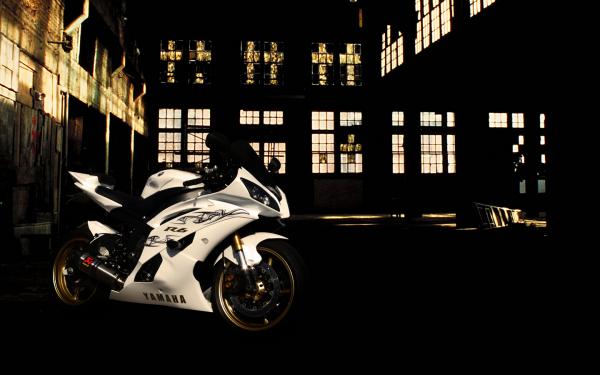

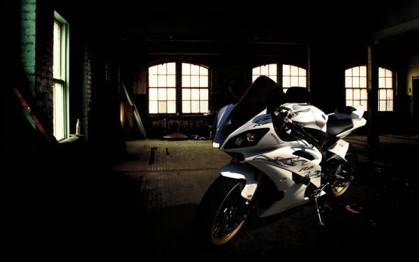

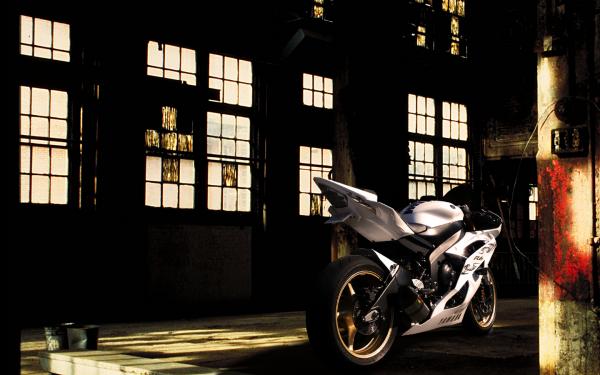

hi everyone~~~ i am going to spray this color pearl white~~ any one can suggest some comment~~~ and gonna find slip on akrapovic or leo vince
spray on ur stock or race ferring?
