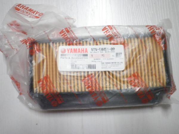

changed air filter

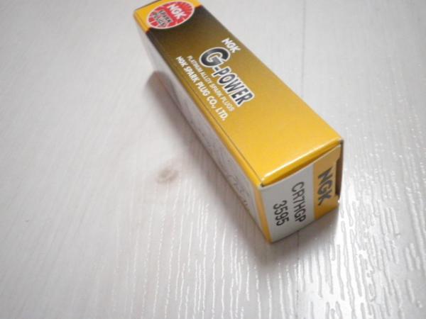

changed NGK G-POWER spark plug

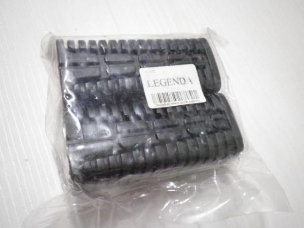

Changed footrest rubber

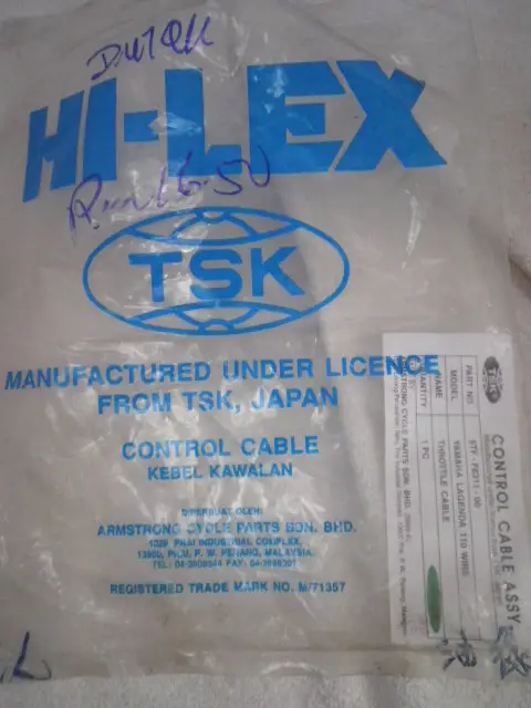

Meter 43719 oct 2011
change TSK throttle cable after 8 yrs
RM 12

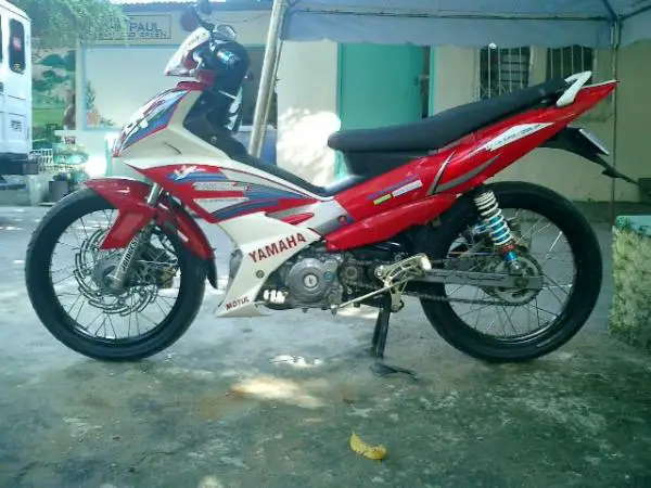

good day i heard a lot of your bike in here,,, im in the philippines sir and my name is john james,
here's my bike 376586_294975907189918_100000325336644_1064172_1637986850_n.jpg
we have the same engine sir... but now my engines is knocking from the right side.
my problem is i cant buy here in our place...
if un dont mind sir can u give some parts that u already used? plss

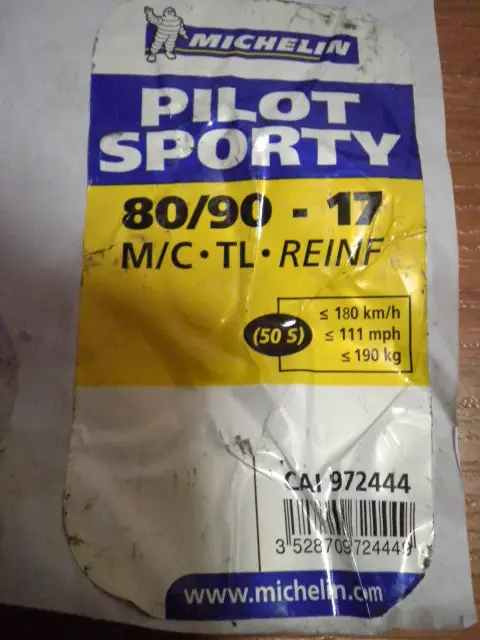

23/11/2011
meter 45929km
changed yamaha siam made brake shoe RM15
adjusted valves tappet setting
Redo spark plug head - changed to suzuki shogun type
changed

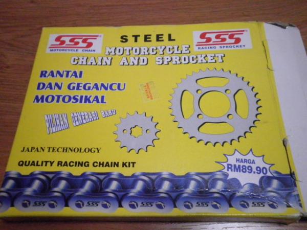

chain drive 15T / 35T ALLOY STEEL brand SSS RM35
Michelin pilot sporty 80/90-17 RM 85

Bought a set of 15T/35T SSS chain sprocket set for RM30 from here.

i use this sprocket set
all original genuine from http://www.kilangrantai.com
made in penang
i buy more cheaper for yamaha spark z in taman setia indah
RM30 one box set
the guy teach me to use SSS sprocket has it has more heated treatment and high steel and use RK chain which is best !

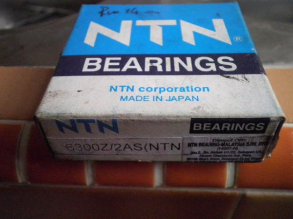

meter 48876 means 148,876 km
30 jan 2012
skudai , Jay Bee
1. changed shell rimula X r3 engine oil
2. adjusted valve tappet clearance

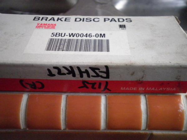

3. changed front disc brake pad yamaha genuine made in msia
4. changed front wheel bearing NTN made in japan ( one sided cover only bearing ) 2 pcs
5. charged battery
6. serviced front disc caliper
wash bike RM 7
engine oil shell RM 15.60
total skudai RM48
Previously used KOYO Japan bearing ( two side covered bearing ) - lasted for > 3 yrs or more.
My advise do not use single side covered bearing. WIll not last long. I wonder what happen to NTN full covered bearing - unavailable.
Maybe fake ntn in msia
yucks
