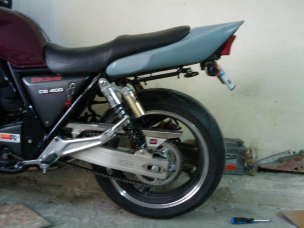

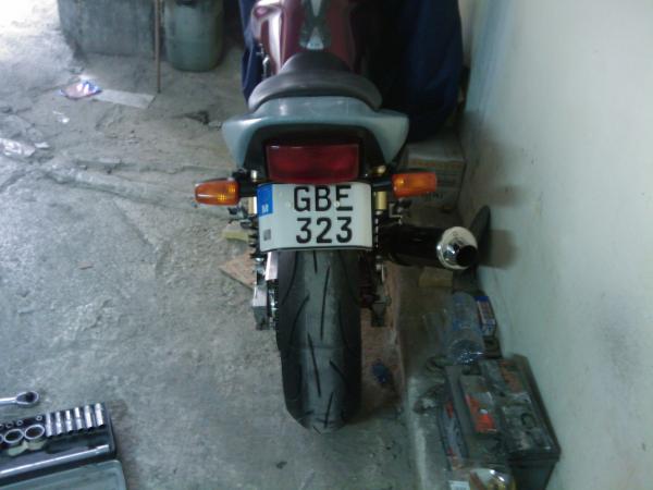

hi this is my 94 pb1, with a hornet rear rim 5.5", and a spec1 fibre glass tail,needs spraying because I'm still fixing the brackets..What do you think?
Nice tail... Btw, the rims come from Hornet250 right? Wat size tyre can fit in?
hi, no come from a hornet 600 , the cb600f pc34 1998 hornet, the rims are made from enkei , 72r. but I had to modify the cush drive and do new spacers. tyre size 180/190.
Wow~! The tyres have enuff clearance at swingarm? Cos I have maxed out my 160/60 at the edges. I'm riding Vtec Spec 3.
hi, the problem is the chain clearance, swingarm is no problem at all.It remains about 3/4 of an inch from the tyre to the swing arm. and from the chain there's only about 7mm. but I have fitted a 170 tyre, so i don't have to do an offset sprocket on the front, to move the chain outwards. there is only 1cm between a 170 and a 180, for me it's not noticable.I used all of the hornet's rear, rim, cush drive and sprocket, except the disc, 400 one fits. I could have used a 180 tyre but it will be too close to the chain.
