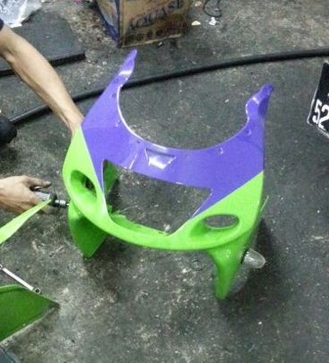

Anyone wants to trade head fairing with me? Mine is a new one just got last month.
I am looking for a plain green head fairing. Interested brothers can PM me your contact details :)
