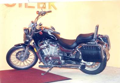

Am plannin to get an Intruder. Can anyone share with me a lil more info abt this bike?
The 1 am lookin at is a 400cc and its shaft driven. FM plater.
Or any Intruder riders around?

I bought a 13 year old Intruder 400, and I could have ridden it as it was. It was reliable, needed little maintenance, and spares were readily available from KS.
You should see the chrome finishing on the crankcase, there was barely any tarnish despite it's age.
It's a heavy bike, and originally designed to be 800cc but to suit the Japanese market, a smaller 400cc engine was used. A 400cc engine is definitely inadequate to drive such a heavy bike, and the shaft drive compounded this problem. However the smooth shaft drive during cruising more than make up for it's slow acceleration.
