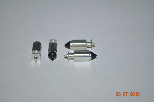

Mine same prob too. just change the overflow pin(4 pcs) on Sat. now felt still hv the prob. will keep monitoring for few more day and see. but after servicing, my bike now felt more powerful and smooth...:)

Then must be your float pin, like mine, same prob last time...

did u mean this?? this is what i changed. 4 pcs of small pin. so call overflow pin or needle valve.
haha. ya. this is call overflow pin. past few weeks i got post about this. :cheeky:
