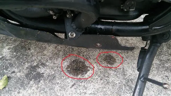

Hi,
when braking at slow speeds, the front fork keep "juddering" or "rebounding" alot , like as if the braking on the disc is uneven. i tout it was the brake pads ,which i just changed as it was worn out , but nv solve the issue. i ask one motortiam at Yishun Indus there he say oil in fork not enough. M jus looking for advice and cost of solving it.
another question is my rear showa shocks are leaking. Previous owner serviced it in sept 2013. JUs need advice on whether to re service or to purchase new shocks, motortiam quote YSS shocks $300+ . worth it or not ah?

Prolly need to Svc your front fork again..
The fork oil maybe have broke down in terms of properties.. Else choose a heavier "weight" oil to counter this prob.. 15W fork oil is abit harder compared to 10W fork oil.. But when it get season, it's just a minor difference.. Prolly Oso just wear n tear & time for u to Svc it
Rear "Servicing" of the shock is CRAP..
Honda doesn't have Original seal for it.. No matter how many times u Svc, it will not gurantee a leak-free shock..
Maybe Oso your Front Brake Pump is spoil.. Making the piston in the master cylinder stuck stuck..
Just ask shop to take a look , or change the Front Brake pump Kit
Tats my tot for you
